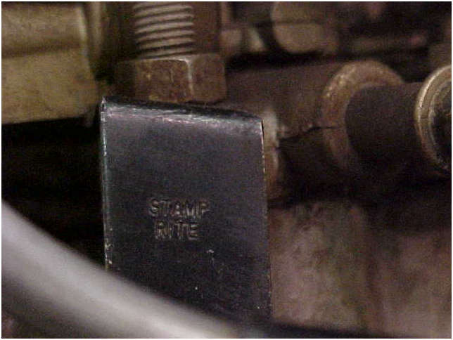

I know you are trying to put everything back correctly and detailing your engine compartment. I can't see it in your pictures. Do you have this bracket on your carb base to fuel line. Should be on later built cars, hard to find and expensive. Just curious. Beautiful car!!

I know the bracket you're talking about as I helped document one on a survivor LT-1 motor that an old friend had about 15 years ago, and no...that's missing from this car.

Don't think I ever saw one of those fuel line brackets on a 1969 Z/28. Maybe very late cars?
