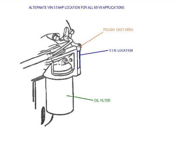

My second week of may Copo camaro. Has the vin above the oil filter. BBBenny

Just like Benny said, the VIN should be stamped down by the oil filter, where the transmission bolts to the block.

Thank You nothing on tab though just 3 casting marks
