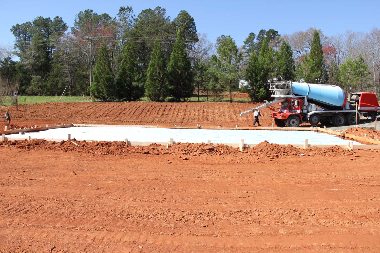

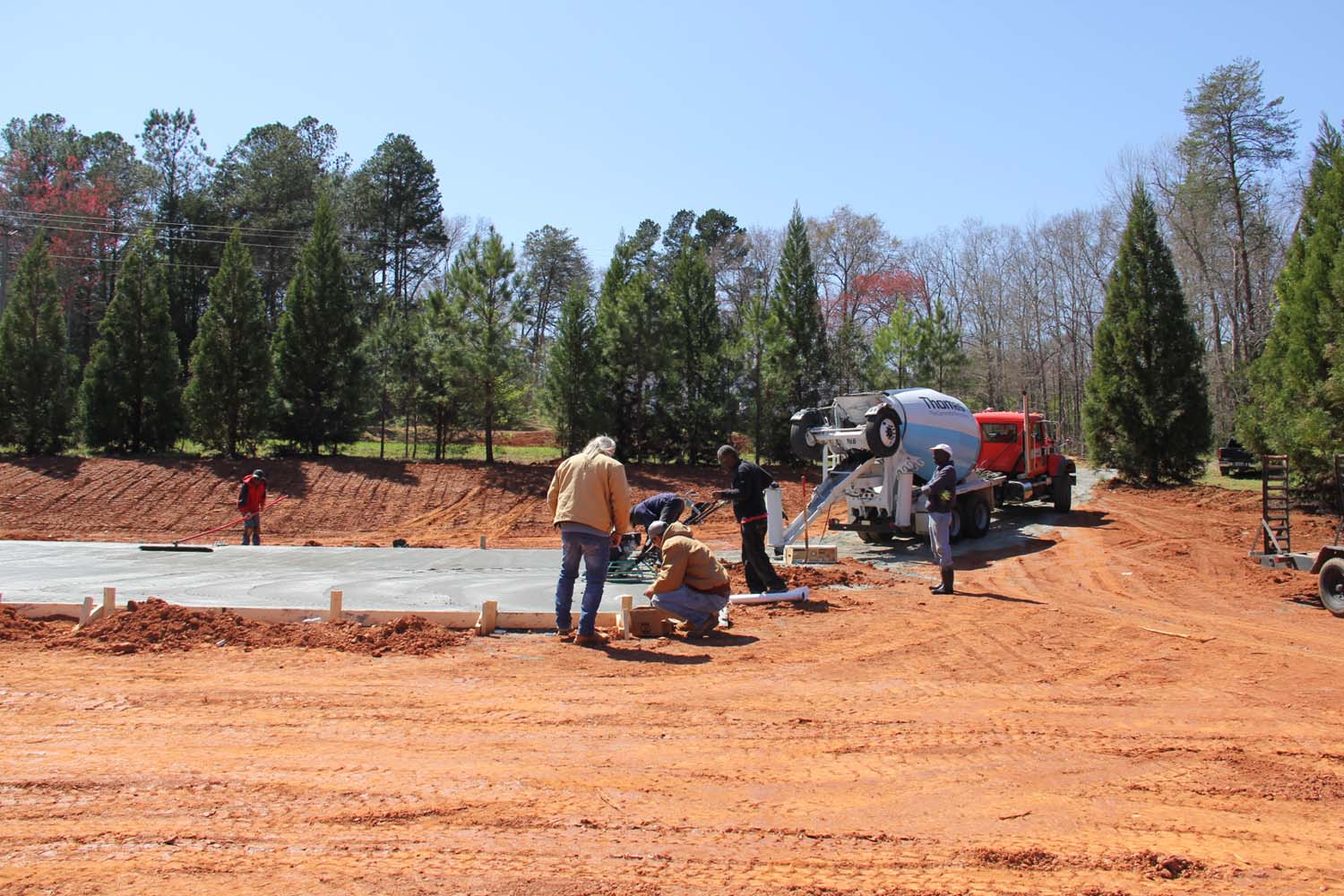

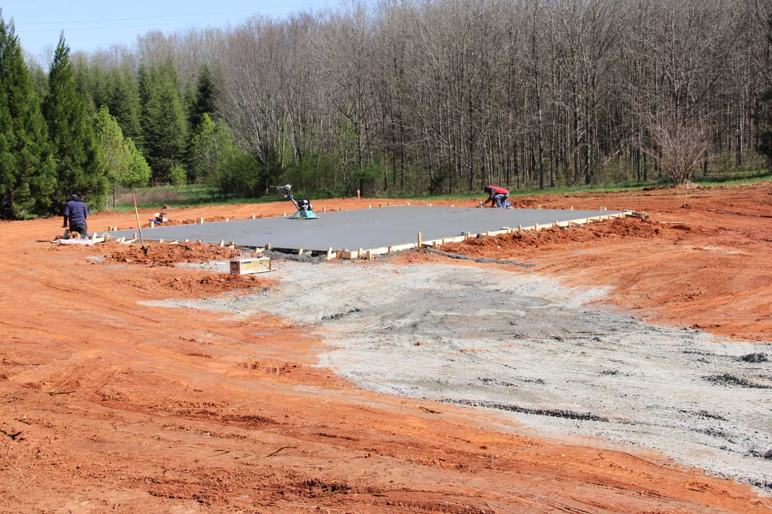

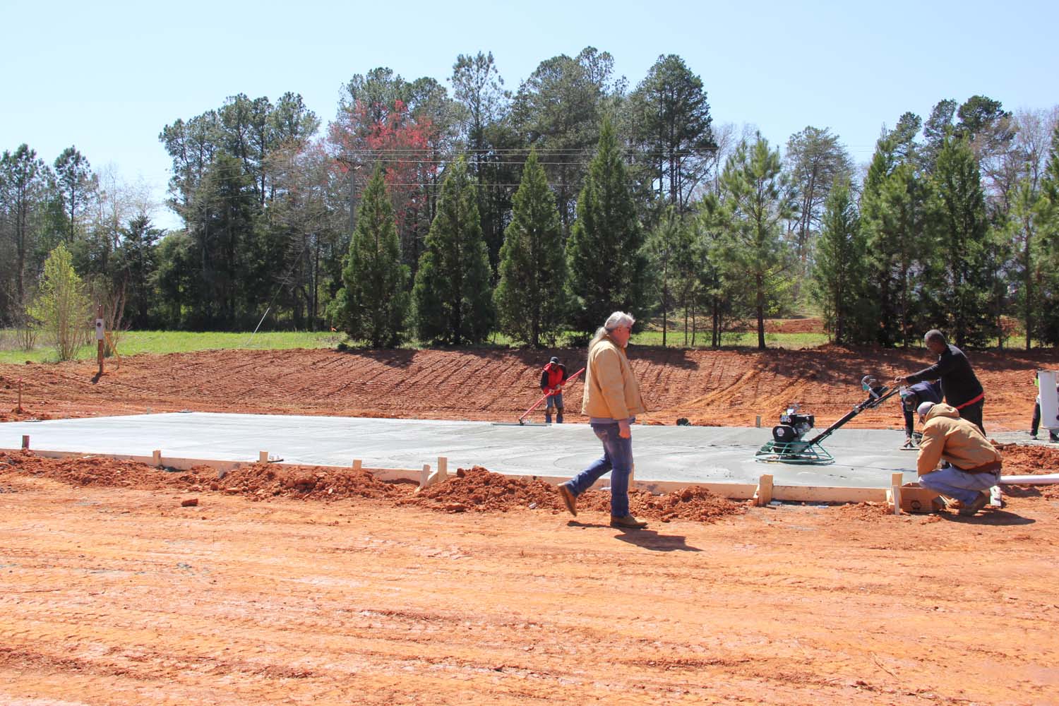

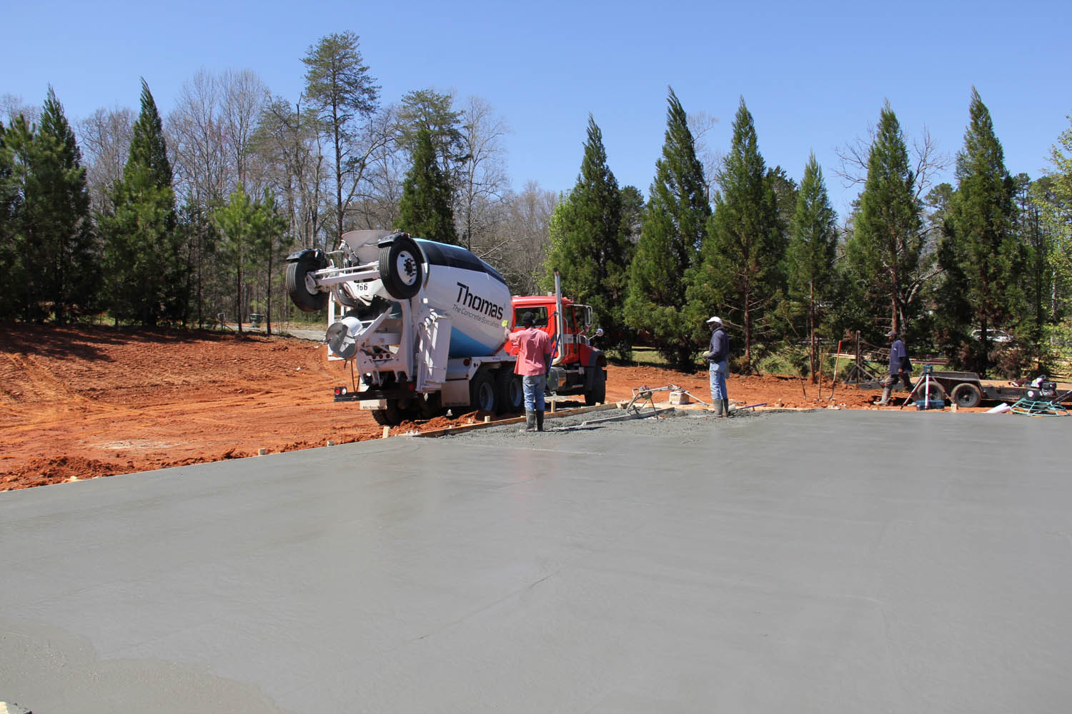

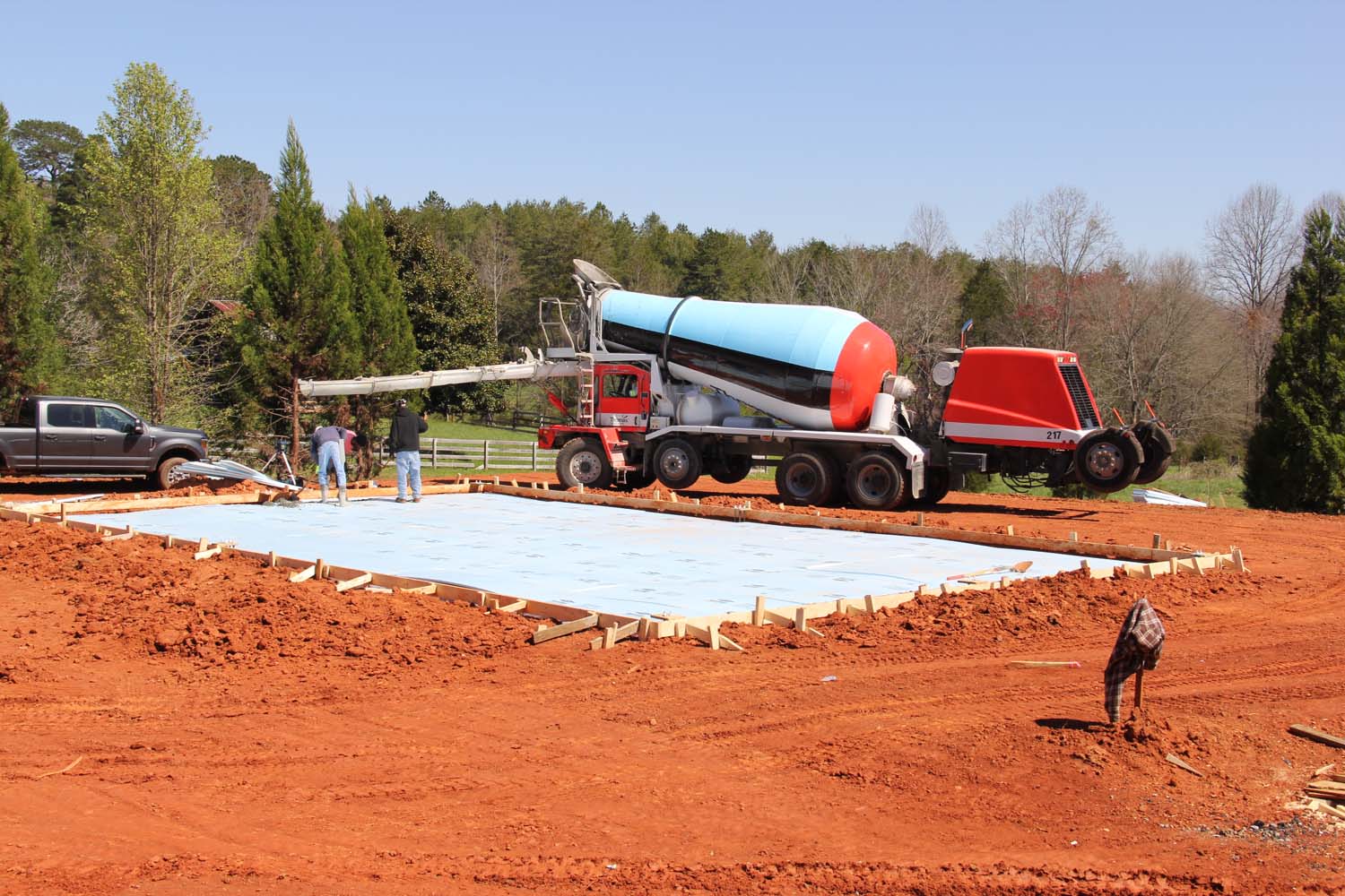

PAD poured today - the building was delivered last week....
Monolithic pad 35 yards 4000# concrete with fiber 51x30 18" footers with Rebar,
1" Extruded polystyrene below grade foam insulation under the pad and footers surround etc, with 6 mil plastic.

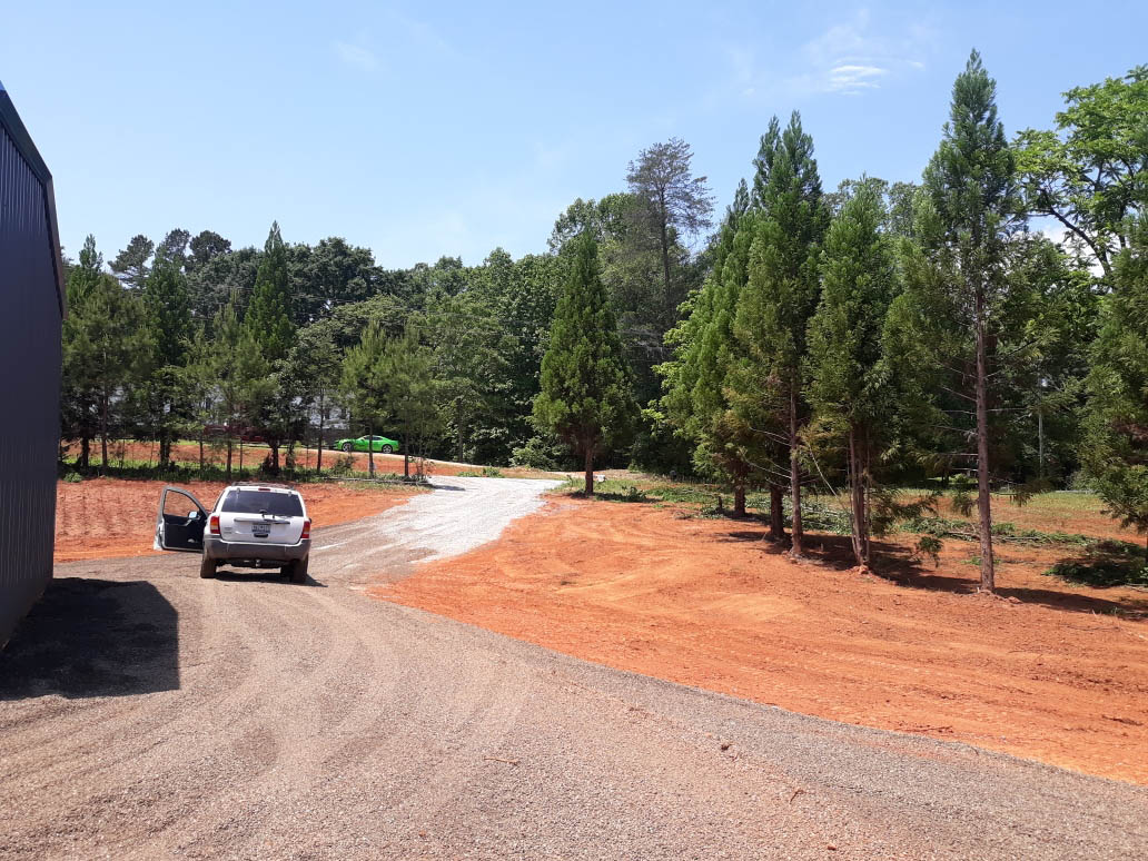

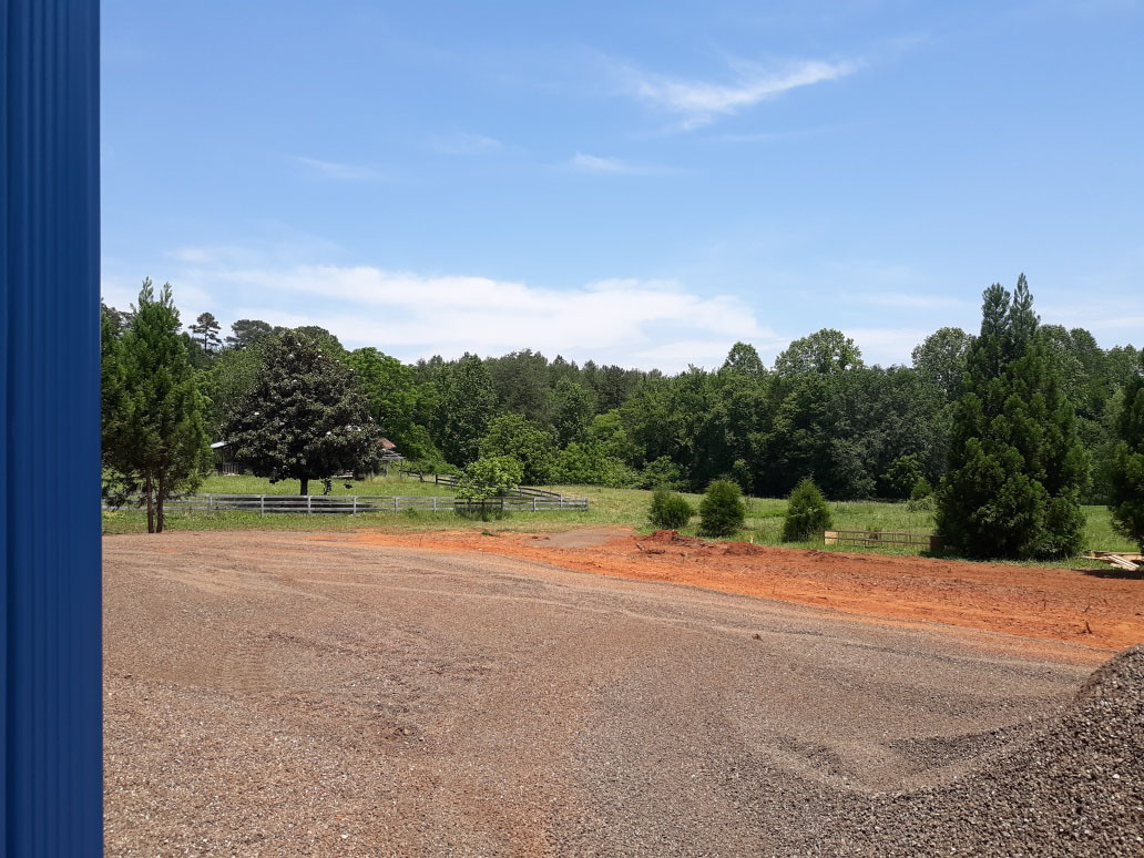

Building was completed 2 weeks ago I have been so busy I just got by the place today.
