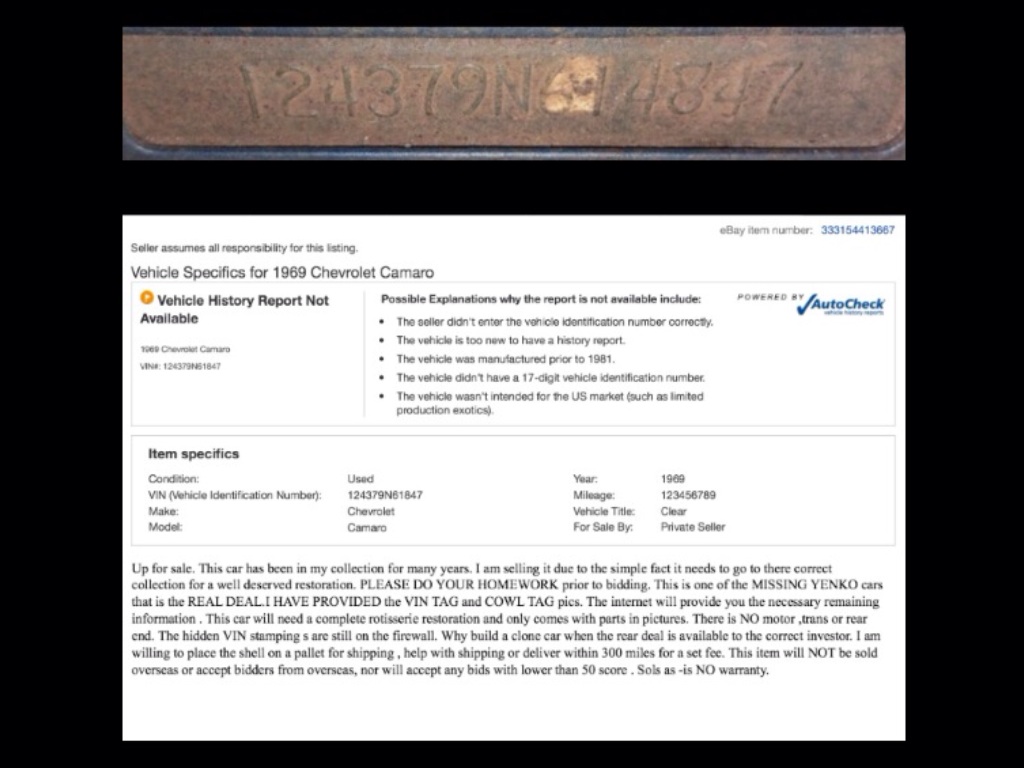

https://www.ebay.com/itm/1969-Chevro...ZcsKd~&vxp=mtr

On the Yenko list here but no Dealer info.
~ Pete

For only $30K, you could own the only dusk blue Yenko! With original tires included!

Wonder why he took a picture of the 4 piston calipers next to the console? Hopefully the 140 speedo can be salvaged, not sure about the rest of the body.

No one noticed the standard production heater?
And with a Blue vinyl top.
Same could be said with no ducted hood wiring hole above fuse box, and wrong throttle lever.

All considered, best grab an NCRS Report to confirm shipped to Yenko as it could be another incorrect Vin recorded by Yenko?

body number is way off.

Looks like we've got two threads going on this same car but everyone arriving at the same conclusions.
124379N614847
