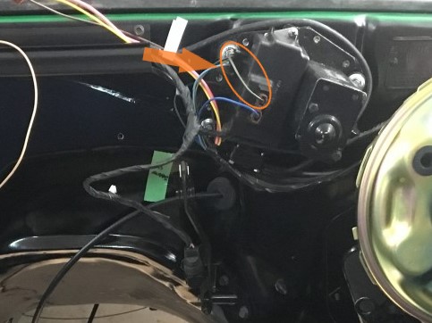

Originally Posted by NorCam View Post
... Cowl Induction Wiring. Have one more speedo clip in the tunnel to finish
Are you using the AAW 'factory fit' harnesses? It appears the wiper motor wire doesn't have a spare mm between the two connections. Mine's exactly the same.
Rob
