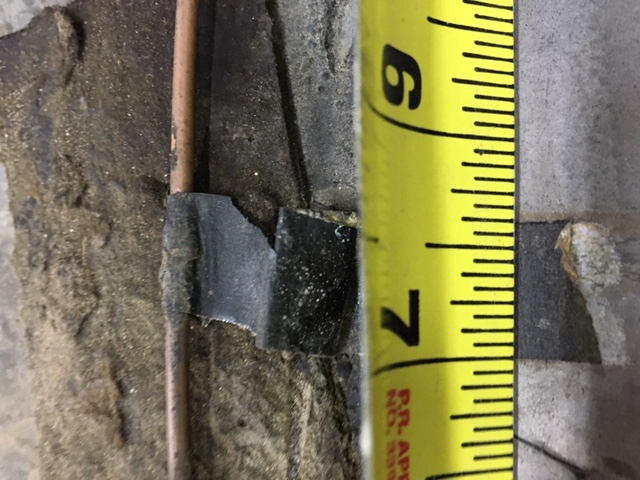

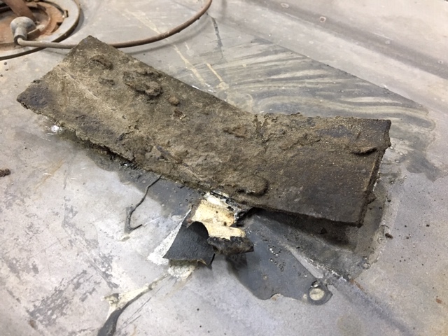

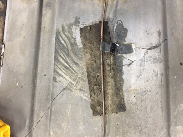

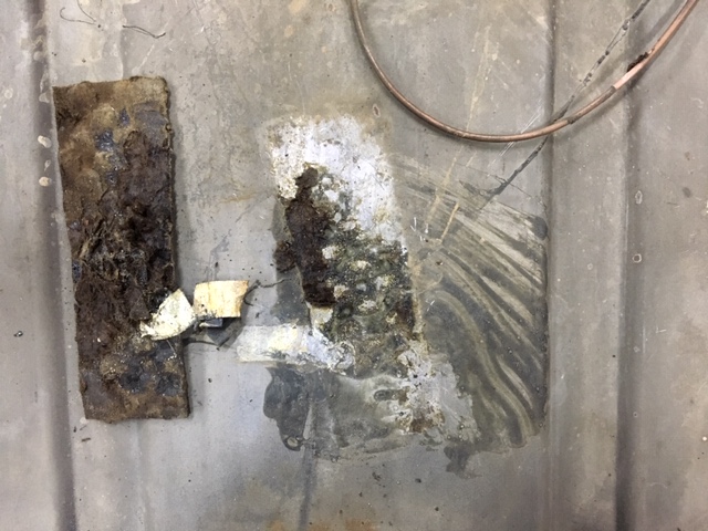

Did some work on my fuel tank this weekend. My ambitions to save it are not as good as they once were...we'll see where it ends up. Anyway found some interesting stuff for the guys that care about some details.
I'll start with some pics before I tore into it. Below photos show sending unit wire routing, tape size/method, adhesive application, and jute pad. I'm not sure I understand the purpose of the jute pad especially when it's under the sending unit wire? I believe all this stuff to assembly line original. If anyone sees something that indicates otherwise, please chime in.

I have seen the same pad under several tanks I have removed over the years. Don't have any input as to why either.
