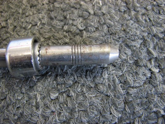

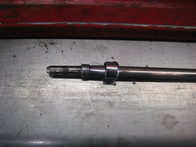

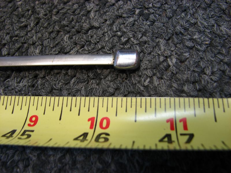

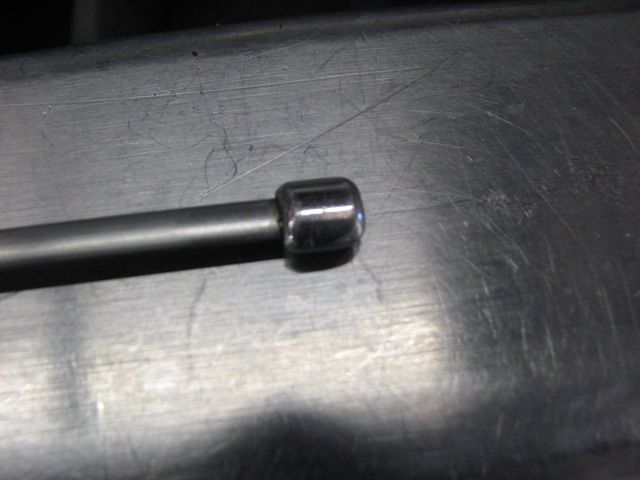

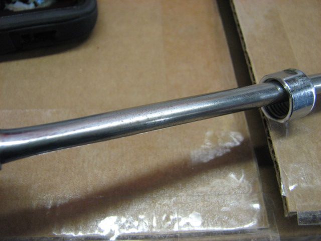

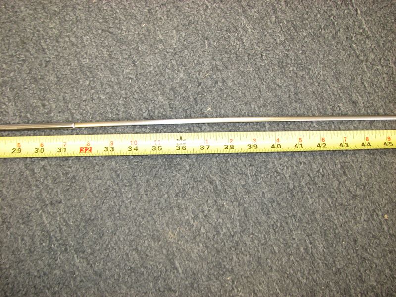

I have had a lot of people inquire about the rear antenna with regards to the length and type of tip on the end. Our tip has NO grooves in it. I am not sure if that is a case of multiple suppliers (grooved vs non grooved) or another case of assembly line versus buying one over the GM counter. Our unit is oval as well and not round.
The overall length is approximately 46.5" with the two telescoping sections measuring in at 16.5" and 31.5". Notice also the base. Hope this helps those who have been wondering.

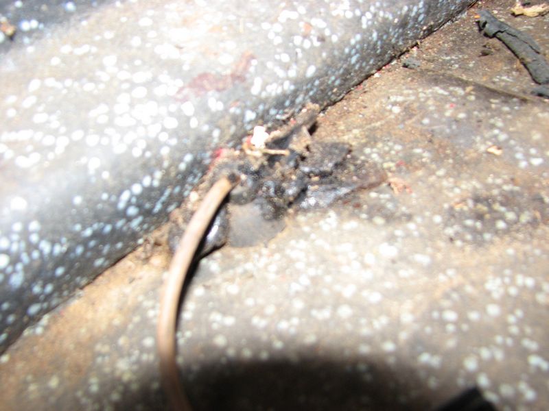

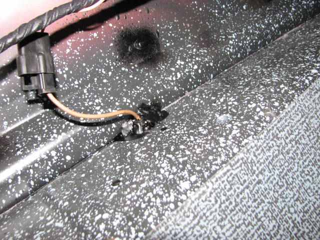

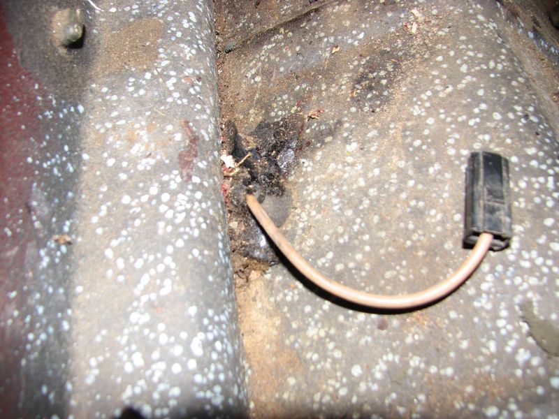

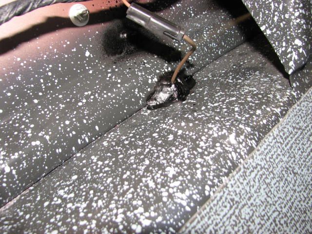

Just a little more detail work in the trunk

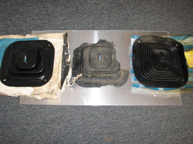

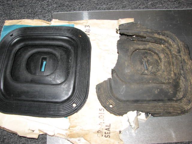

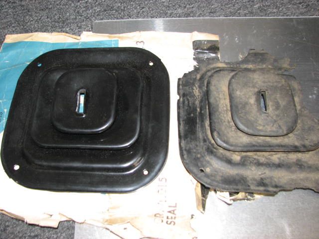

Huge shout out to Grady Burch for cutting one of his very valuable parts loose. As you can see in the photo, the correct NOS shift boot is on the left, my rat, mouse and racoon eaten original boot and the last photo is the more common replacement NOS boot. From what I know, the original boots are much thicker than the replacement boots and would cause the shifters to pop out of gear so GM replaced them with the taller, more bellows and thinner version. I remember this issue when I owned my 69 back in 1981, the shifter would always pop out of gear when you would take you foot off the throttle. I always thought it was the shifter or internal transmission issue when in fact it was likely due to the original boot putting too much tension on the shifter as it is so much stiffer than the replacement. Thanks again Grady for cutting this one loose as these are pretty tough to find.

That's a part someone could fairly easily have reproduced and would sell like hotcakes.

That is the problem with most reproduction parts, they produce and sell what is most commonly found or used as second design parts and not necessarily assembly line parts as they can cover a much broader audience as well as more years combined.
