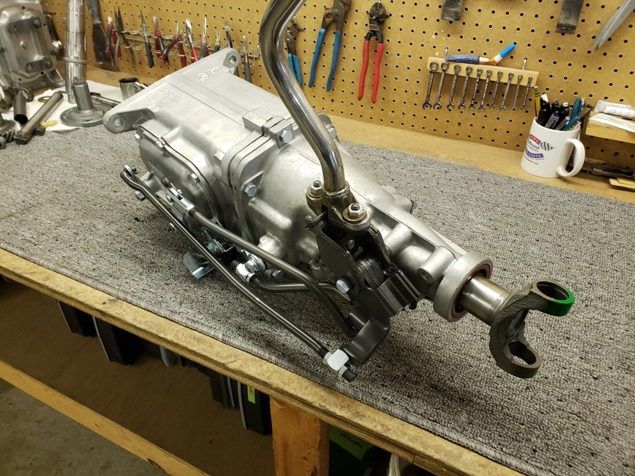

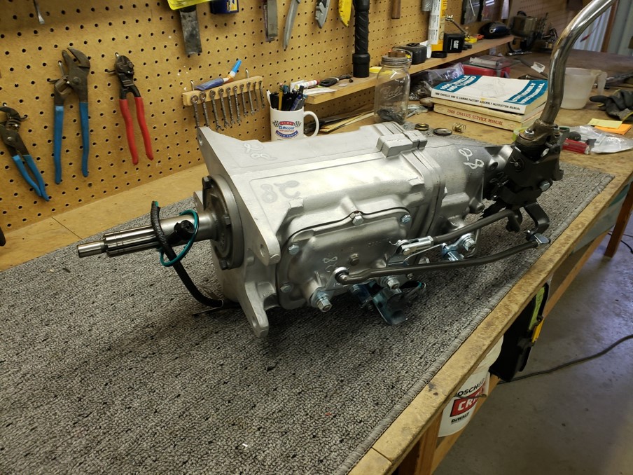

Default Original M20 Trans
Finally got this put together and tested/adjusted to make sure it shifts smoothly. Made sure to put back an original 3890534 tag. Im most surprised how good the early muncie shifters feel. Very solid. I had to rework a few items to tighten things up but still impressed.

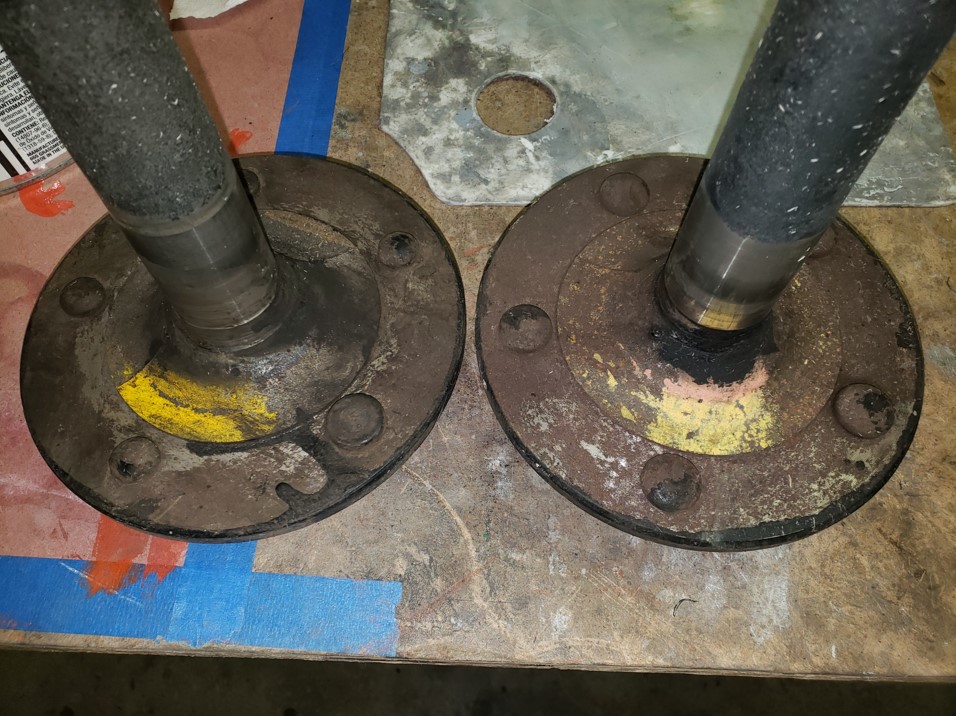

Default Axle Markings
First restoration that the axles were still good to use. Only had to change one stud. I think the car was taken pretty good care of over the years.
