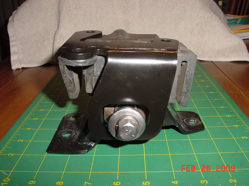

Were these really used in the later production 69 Z/28's? There is a reference with a date change on page A4 of the Z28 option in the assembly manual but I see very little mention when I Google the subject.
I found this 3977985 spacer with some of my other stuff and wondered if it was actually used in production.

I have only seen one. It is on a 10D original owner car. The motor had been pulled years ago and it was installed back on the Right side?

Is this what your referring to ?

Yes. That's it. According to the assembly manual they were installed on the left side only.

I had one on a June car that I sold to Frank DiHartce years ago.

I have one on my June Z

Those pieces are also shown for late issued big block cars, LH only.
I'm looking for those pieces for the car I'm restoring if anybody has some....Joe

Something like that isn't reproduced??
Looks like a fairly simple design to make.
Maybe I'm looking at it wrong but with that mounted, won't that raise the engine the thickness of that bracket?

Yes it will.
