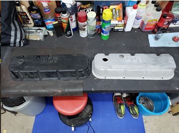

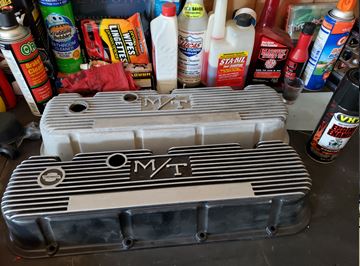

As stated prior I did find some M/T valve covers in great shape. One was spray bomb black so I have been testing on how to polish the fins. I have them now both prepped for paint hopefully I'll get to it tonight.
Jp - congrats on getting the M/T VCs! No taping necessary. Paint 'em black and then attach a sheet of sand paper to a board and lightly sand the tops of the ridges of the fins off. Easy peasy! Looks crisp and right!
Thank you Mockingbird! I found a paint stripping wheel on a drill works very easy on removing paint from the fins. Your car is my motivation for this!
