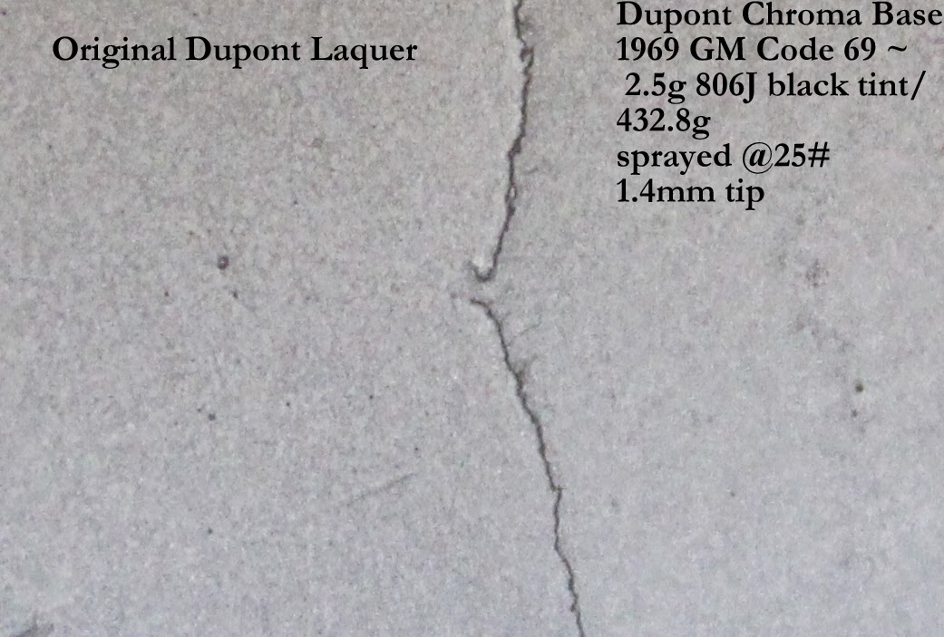

FOLLOWING PHOTOS FOR EXAMPLE CORTEZ SILVER in CromaBase - required 2.5 grams 806J black tint per 432.8 grams of formula in order to bring it in line with the original. This one was fairly easy, a couple of hours, however the light copper metallic (which has a list of tints so long it took 2 columns) took probably 10 hours total to get the match. The side shift AND COLOR were wrong with the first mix and I had to study the tints in order to determine which one needed to be altered.
