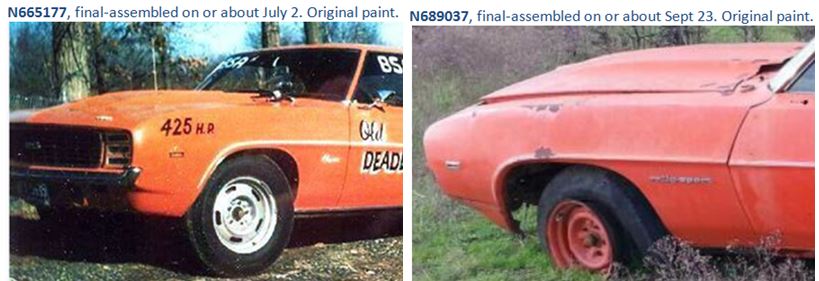

I thought the '69 RS COPO Camaro's had a Camaro fender emblem?
- Warren
You are correct on the fender emblems. There are other items incorrect on this car also.
- Warren
http://www.camaros.org/copo.shtml
Check out the 5th paragraph in the " application to the Camaro chassis " through June they Recieved the Camaro script.
Check out the 5th paragraph in the " application to the Camaro chassis " prior to June they Recieved the Camaro script.
Mike, do you have that before and after June info turned around?
I have not seen a RS COPO with the Rally Sport emblems on the front fender. A friend of mine has an original 06A build RS COPO 9561 with the Camaro emblems on the fenders.
I know better than to say never, but that info is new to me.

I edited my post to read....through June....they got the Camaro script.

The Camaro emblems on RS COPOs extended to early July '69 at least.
The Mecum COPO [N624797] probably should have Camaro fender emblems.
At this time, no one knows how many RS 9561 COPOs were built.
