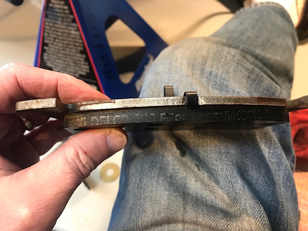

Factory Original, OTC replacements, other? Application: ‘69 Chevelle SS

Sam,do they have the wear squealers on them? Application would be all GM A Body 69-72, X body 69-74(?) and all 69 F body, cannot speak for 70 and later F body as I believe the wear squealers came in about 1972.

No squealers. The clip you see is to retain the pad to the disc brake piston. Thanks for the info.

I am easily confused - So, are you saying a 69 GM A body (Chevelle SS) would have wear-squealers from the factory? Or did wear-squealers debut in 1972?

D52 pads fit 69 thru 77 mid size and full size GM's, and maybe even more.

Squeakers cam in in 72.
