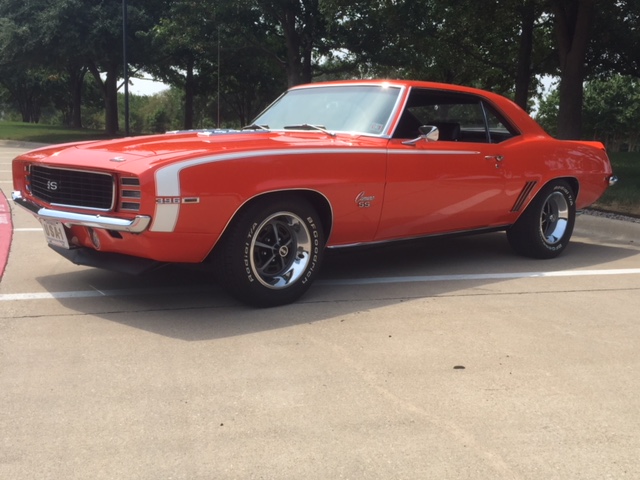

Surprised more folks on this site have not done what we are trying to do. The easy way is to go with new BFG's like I have and be done with it.
215/65's in front and 255/60's in rear put the stance where I like per my picture. My rear must sag a little so the extra inch on the 255's makes my car about as level as one could get. I had the factory Poly style GY's on the Z I had and liked them a lot. But was wanting a little attitude with this Hugger car.

Yep, yours looks good with the 215's and 255's. That's exactly what I have at the moment. The 255's do a nice job filling up the rear wheel wells while still maintaining the near stock tire height of the original Z tires. I may go to a 215/70 on the front that is 27" tall to match the rear but I'll have to wear out the 215's first.
