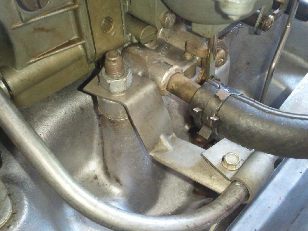

A friend of mine sent me this picture of original 69 Z/28 carburetor studs a few weeks ago. From his survivor RS Z with the fuel line bracket still intact. I don't know why but these fuel line brackets are rarely ever seen. I haven't seen more than two of them intact? Made by same company who did the bracket for the brake booster hose on the opposite side of the intake,
Is that Skips car? Appears the carb stud is gold cad also........My late car 11A has that fuel bracket but it's not painted black it's natural or was plated silver cad.
Mike T's Car (RSZMJT) which is an 06A Norwood Canadian Docs RS Z/28. He's the second owner and has had it since the mid seventies. Unmolested and has around 47K for mileage if my memory is still intact.
