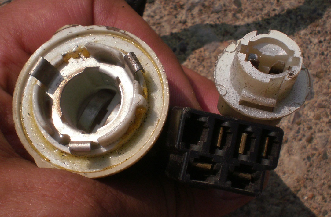

Got this from a friend who told me it was from a 67 to 69 Camaro but I checked all my buddies Camaros last night at a cruise and none of them matched.
If you can help Thank You in Advance. (See Photo)
Has Original Tag with AA 1336
Attachments - The Supercar Registry wiring harness 005.JPG wiring harness 004.JPG wiring harness 003.JPG wiring harness 002.JPG

One More Photo

Uh......that looks exactly like a 70 Chevelle harness to me though the harness decal number is not what I expected as it should be 9390. ??
Thanks Rick, I am a dumb ass, Sold all my Tail light housings and never thought to look at my own car as the white bulb connectors hook up to them and I can't see them from the trunk. DOH
These are a Perfect match to my Kansas Built SS with the exact same AA 1336 Tag in my trunk.

XXXBLACKLS6M22:
That is a 1970 Chevelle trunk taillight harness. My Baltimore built LS6 has the exact same code.
