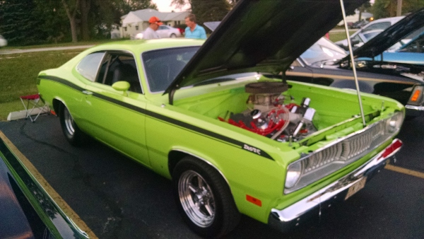

A friend of mine has one in his hemi Duster he drives it on the street a lot and doesnt mind it. Its pretty funny when we go to cruise nights and people look inside and try to explain to who they are with what all those levers are
