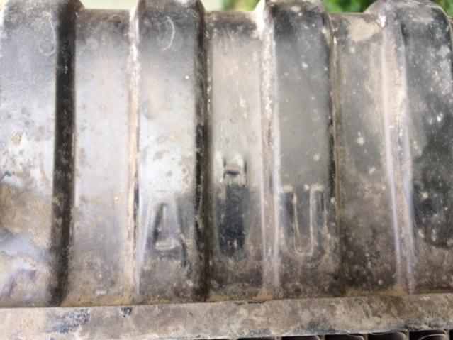

would like to know if anyone can id this harrison radiator,i believe it may be for a corvette do to the absense of a filler neck but ? Tanks are coded IK and AU with a tag that says mt.

There can be a number below the MT. If so, that would be the radiator's part number. Is it readable?

67 or earlier.
http://www.camaros.org/coolingsystems.shtml#tag

#s on the tag are 3010167 ? anybody?

Default part number 3010167
1967 to 1969 G-10, 20 van 8cyl

Iam always amazed of the knowledge on this board, that make sense thanks guys.

That explains the filler tube and no filler neck.
