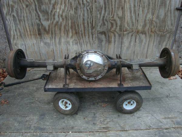

looks pretty bad to me you can be the judge

Original 69 Chevrolet Camaro 427 COPO 12 bolt rear end. This is an original BE rear end that was in a race car for many years. Currently has 4.56 gears with spool, Moser axles, and c-clip eliminators. Casting date is D-11-9. Assembly date is BE 0416G2. Will need original spring pads installed and ladder bar brackets cut off to go back into an original car. This is a must have for any original COPO or Yenko 427 car. $5500. 609-320-8025 Matt. No texts.

It's common to see the marks in the area where the axle code is but, I wouldn't think the BE would still be so clean... Looks like a bad re-stamp to me. Not even similar fonts to an original axle code.

Sorry, not "buying" it...

I don't have any BE rears with that date. I do have BL rears with that date though.

looks like D 11 9 cast date. are you saying that it was a BV or it's a '68 BE?
