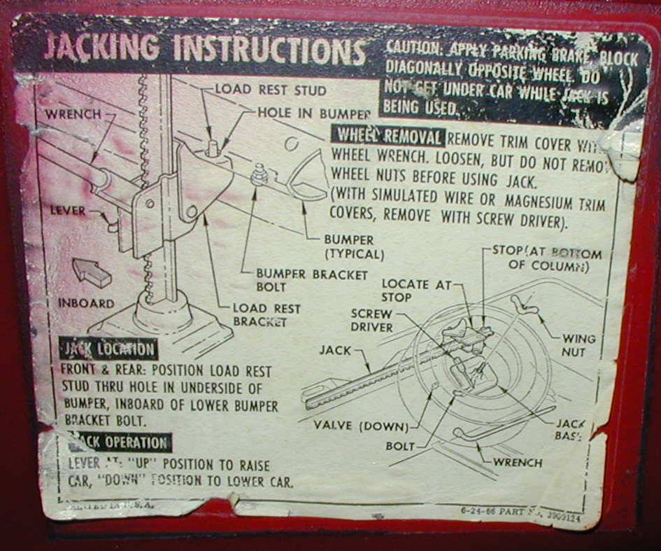

The screwdriver had a part # and appears in the appropriate jacking instructions.

Kurt,
Do you have a picture of the instructions with that info?
Thanks.

<div class="ubbcode-block"><div class="ubbcode-header">Originally Posted By: Woj</div><div class="ubbcode-body">Kurt,
</div></div>
Kurt S - CRG
