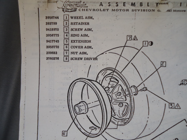

I've only seen 2 Hex bolts used with no washers needed behind the retainer,originally.Obviously this is for the bolt on caps,and not the spring steel retained clip on caps used during most of the '70 production.
Becareful to not over tighten with the socket,as those pot metal threads can be stripped quite easily,especially after the cap has been re-plated and the acid weakens them.
1970 Chevelle Assembly manual..

Rick, it's interesting that the 70 assembly manual has the components of that wheel illustrated, whereas the 69 manual does not.
