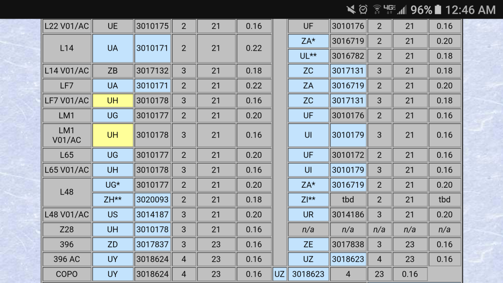

There's usage info and tag codes listed at the CRG cooling systems data here:
http://www.camaros.org/coolingsystems.shtml

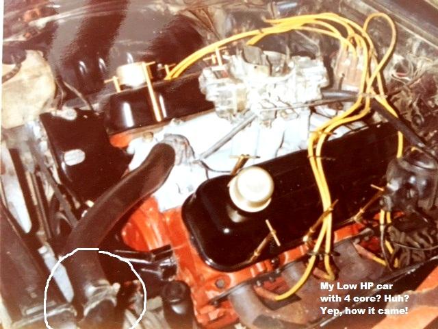

And then there are anomalies, December car. Picture from 1980. The way my car came.
FULL OWNER HISTORY

Entirely possible they substituted a 4-core radiator for certain option combos.
Optional V01 Heavy-Duty Radiator application info states: <span style="font-style: italic">Included when air conditioning is ordered. Not available when 396-cu-in engine or Special Performance Package is ordered.&quot;</span>
PHR tested an L89/auto '69 Camaro SS/RS [11A L507834] in the April '69 issue. Article states the car had 3.73 gears. Engine bay photo shows a straight-neck radiator.
