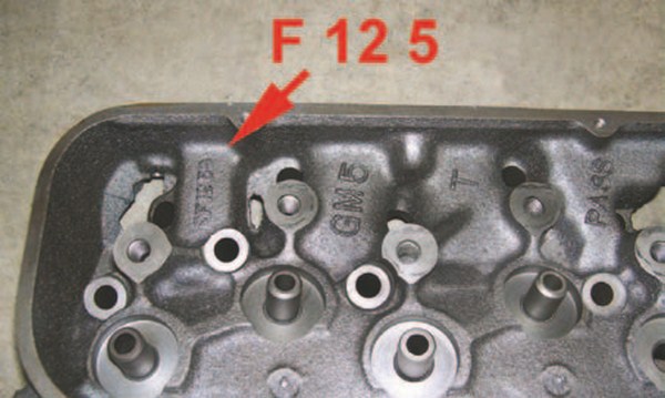

Cool find Mark,
The dates on the heads are on the undersides of the intake runners so they can be seen simply by removing the valve covers. The heads would be cool to have but are available. The block is the truely rare piece.

Keep us updated & share pictures..And for the sake of the obvious,make sure it isn't really CKO,CKQ or CKR.
casting dates can be in various places,but as Jason said,easily seen.

Oooops, I meant to say can't be seen by simply removing the valve covers. Dates are on the underside of aluminum heads.

No change over period.All 1970 BB solids did have the #569 intake..Someone removed it and installed a #163 later on.
I would STRONGLY suggest you trying to obtain those early 1970 dated #842 heads if this engine block is indeed from that block & from a 1970 L89 Nova.
Their dates are key.
