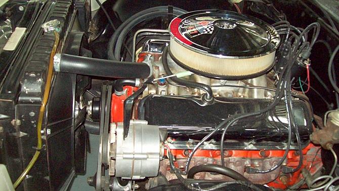

For your reference here are pictures from the 700 mile original car sold at Mecum a couple years ago and now owned by David Bongarzone
And also from the car known as Ennis' Menace.
Looking at pictures of your car, it looks like the fan is right at the edge of the shroud instead of half way in, the spacer would fix that.

Here's a try at the pics.
Nice to see you here again Pat!
~ Pete
<div class="ubbcode-block"><div class="ubbcode-header">Originally Posted By: Pat_Dilling</div><div class="ubbcode-body">
</div></div>

In regards to the radiator spacer question I am not sure but this is what we have found in the 1968 assembly manual. It shows that if the car was ordered with heavy duty cooling option which mine has it should have big radiator(4 core), clutch fan, fan schroud but it doesn't show the radiator to core support spacer. I know sometimes the assembly manual is inaccurate but wright or wrong that is why the restorer didn't use it. i know it runs cool enough the way it is.

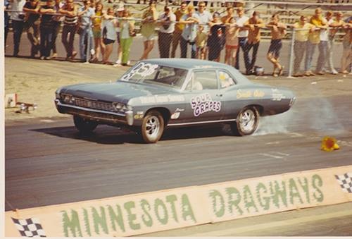

Is this car &quot;Sour Grapes&quot; the same car as the one that is for sale here? The colors look more blue versus green on the car for sale?
If it is the same car, is there any proof to that effect since there is no documentation with the &quot;for sale&quot; car to prove its a real L72?
