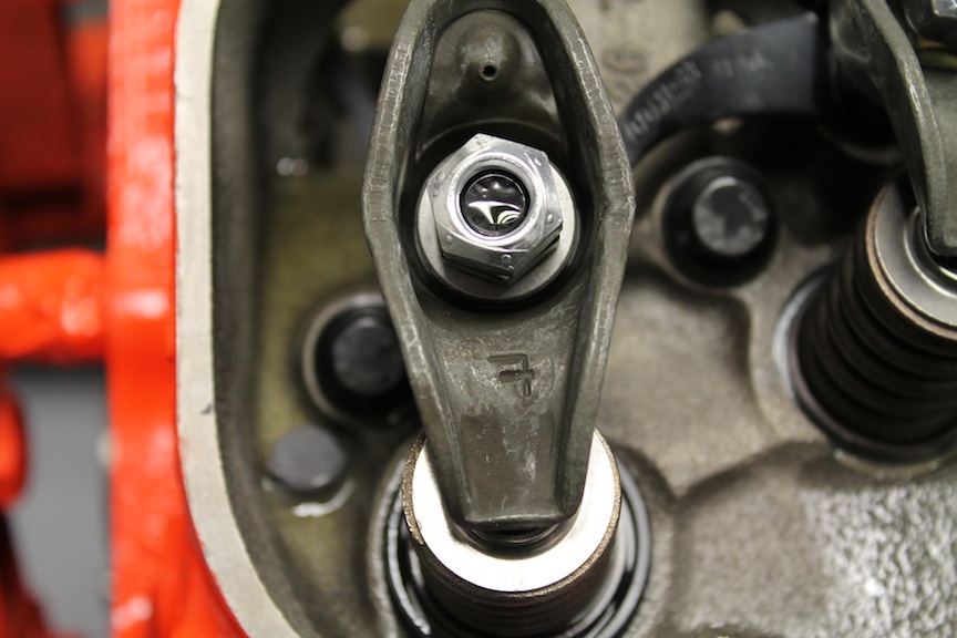

<div class="ubbcode-block"><div class="ubbcode-header">Originally Posted By: COPO_Anders</div><div class="ubbcode-body">
Do you have a picture of your &quot;236&quot; heads before the combustion chambers were worked on ? I looked at my &quot;360&quot; heads today and the combustion chamber looked a bit smaller om mine.
[img]<<GRAEMLIN_URL>>/biggthumpup.gif[/img] </div></div>
Here you go.
