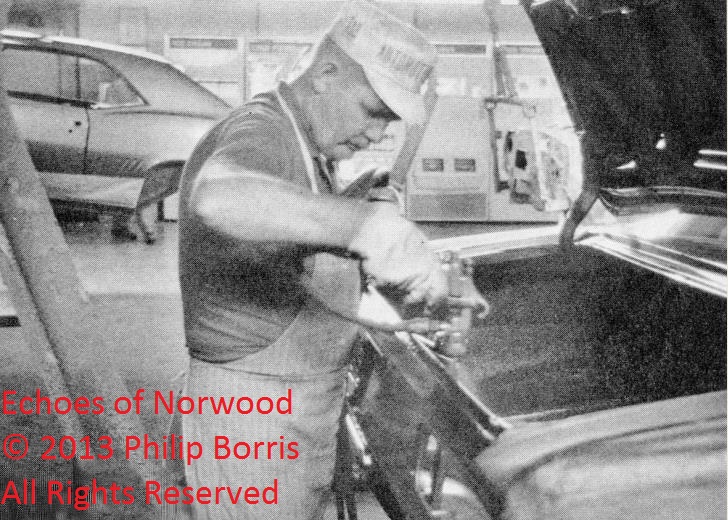

From a guy who was there...
"JohnZ
CRG Member
Posts: 4308
View Profile
Email
Personal Message (Offline)
Re: black on tailpan on ss cars
« Reply #21 on: June 16, 2009, 10:23:49 AM »
Quote
I'll go against the grain with this one too - I saw hundreds of them coming down the line at Norwood iin February and March of 1969, and I never saw one that was gloss black."
