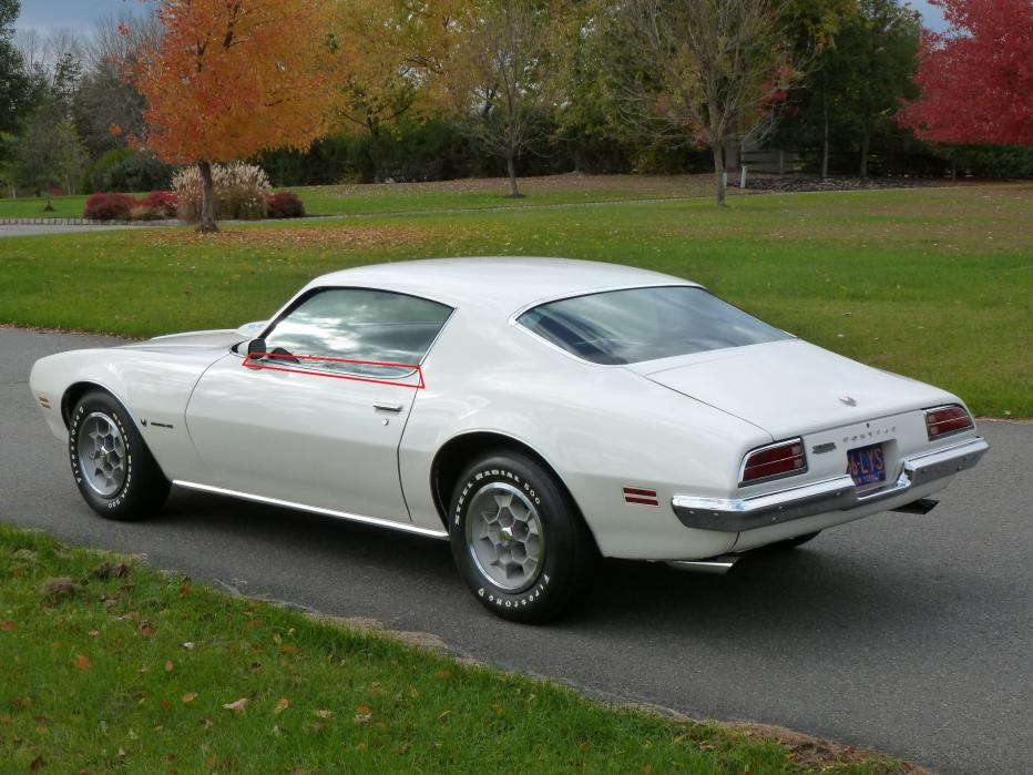

I’ve seen many places advertising rubber and trim for ’70 F bodies but would like the recommendation of the collective……
Most things are still in great shape but I’ll have to replace some window molding and the squeegee molding (not sure of the name of it, but it is between the outside of the door glass and the body).

You definitely should move this thread over to the Pontiac section just for ease of finding it.
There are two different outer door rubber "squeegee" moldings as you call them. It depends on whether you have the stainless steel molding on the top of the door or not.
This molding, outlined in red:
