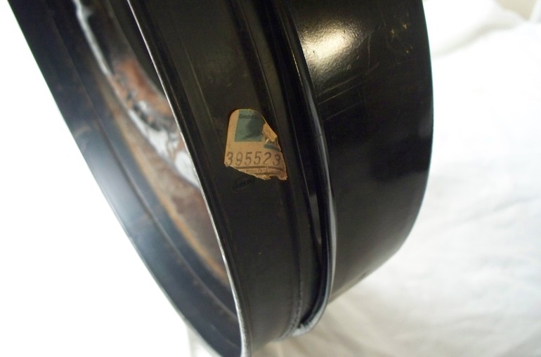

Here's what he's looking for.

<div class="ubbcode-block"><div class="ubbcode-header">Originally Posted By: paceme</div><div class="ubbcode-body">Eddie, some are not stamped with Demco. I believe they are 2 1/4 inches. The SS 350 spacer is larger around 2 1/2 inches. </div></div>
302cid used extension #3955233.
350cid used extension #3955232.
