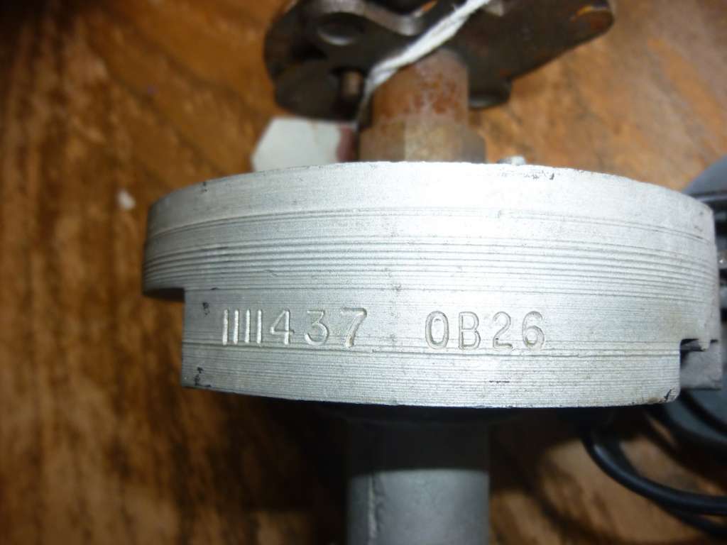

Is this a real one?

Not real
No Fisher priced toys here

Nope! Not one of the run dates either.

Thanks much for the quick answers!

Over on Team Chevelle someone actually used a mic to get the factory diameter of a distributor for reference when someone turned one down to do a restamp.
Kurt
EDIT: I just measured 3 original distributors with a dial caliper and they all came out to roughly 3.80-3.81 in.

That is good info, Kurt! [img]<<GRAEMLIN_URL>>/biggthumpup.gif[/img]
