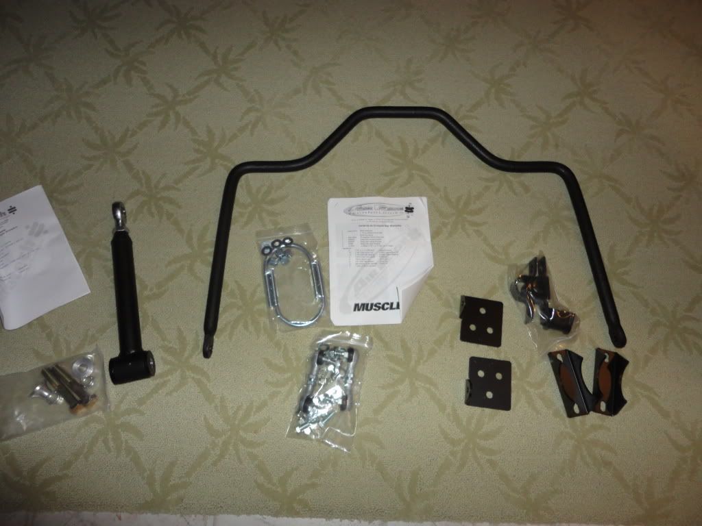

Got a couple more boxes today........Rear Sway bar and because I switched to a 12 bolt, I needed to order another upper control arm (10 bolt has 1 ....12 bolt has 2)so....the suspension is now complete......Can't wait to get to the point to where I get to put all this stuff on the car.....

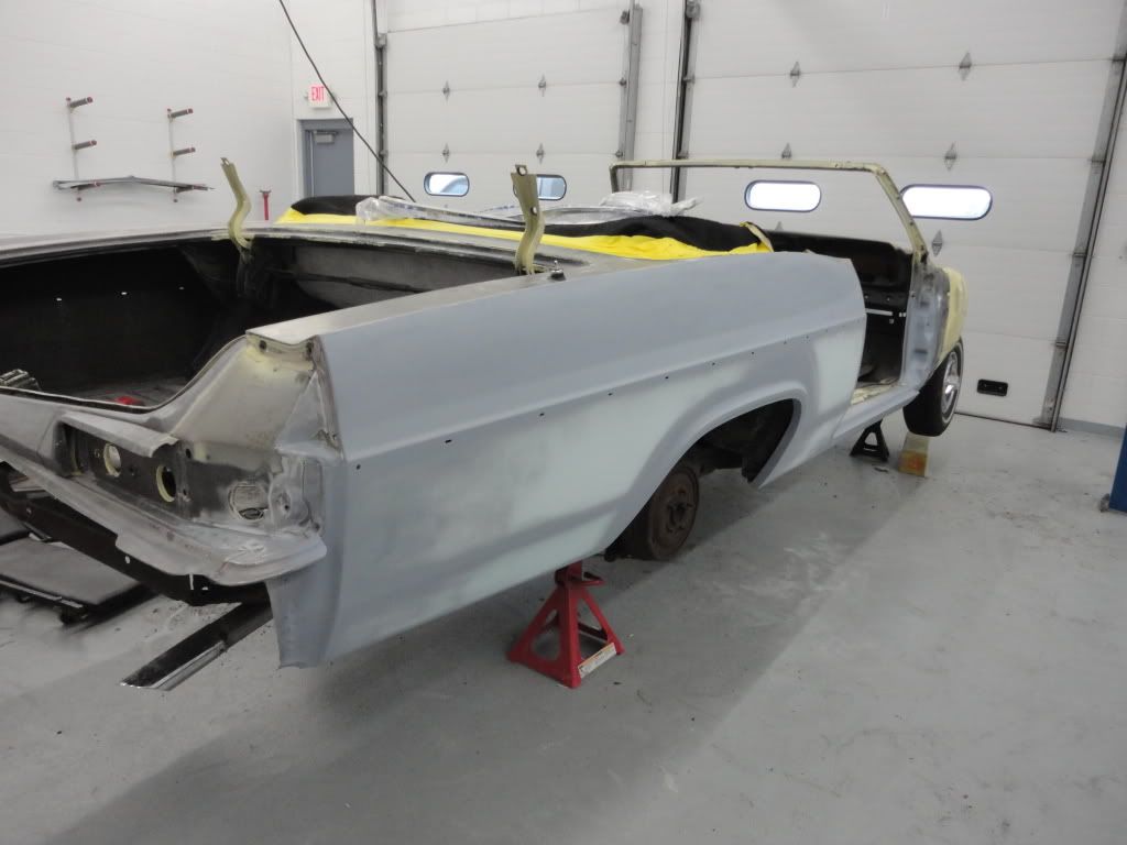

I also stopped at Pulera's today as it was Georges first day back this week........he has the passenger side quarter ready for priming........

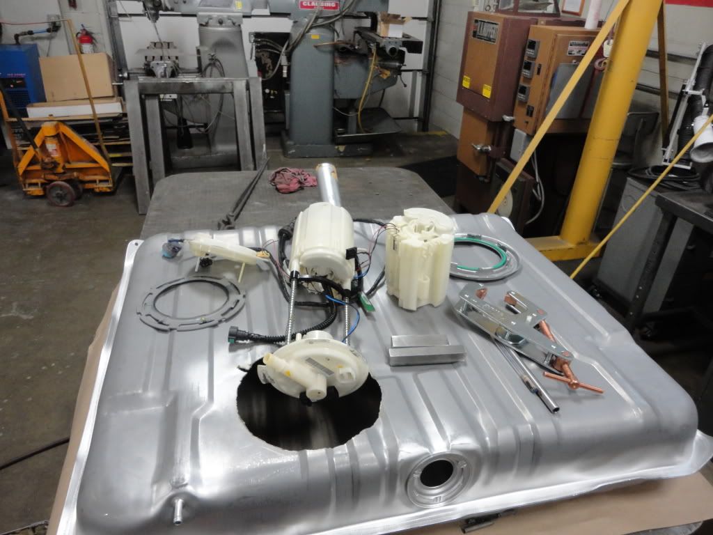

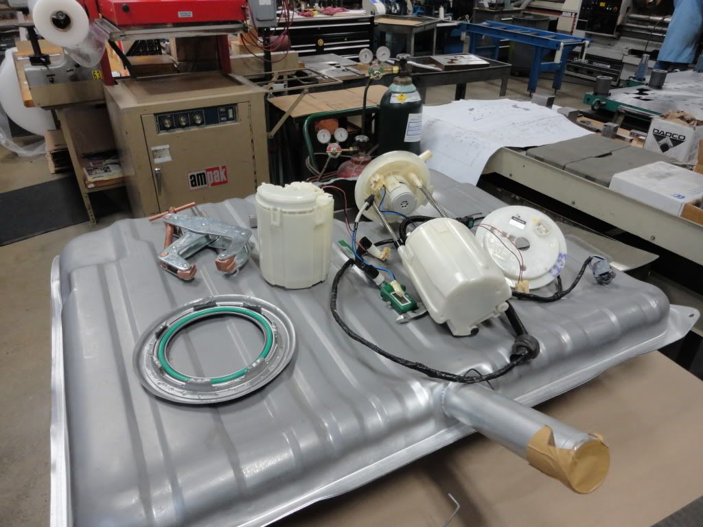

And.....at the shop the next task at hand.......Getting the GTO pump assy to fit in the 66 Tank......More Pic's to come...
Right now it's a big mess, but......there is a plan.......

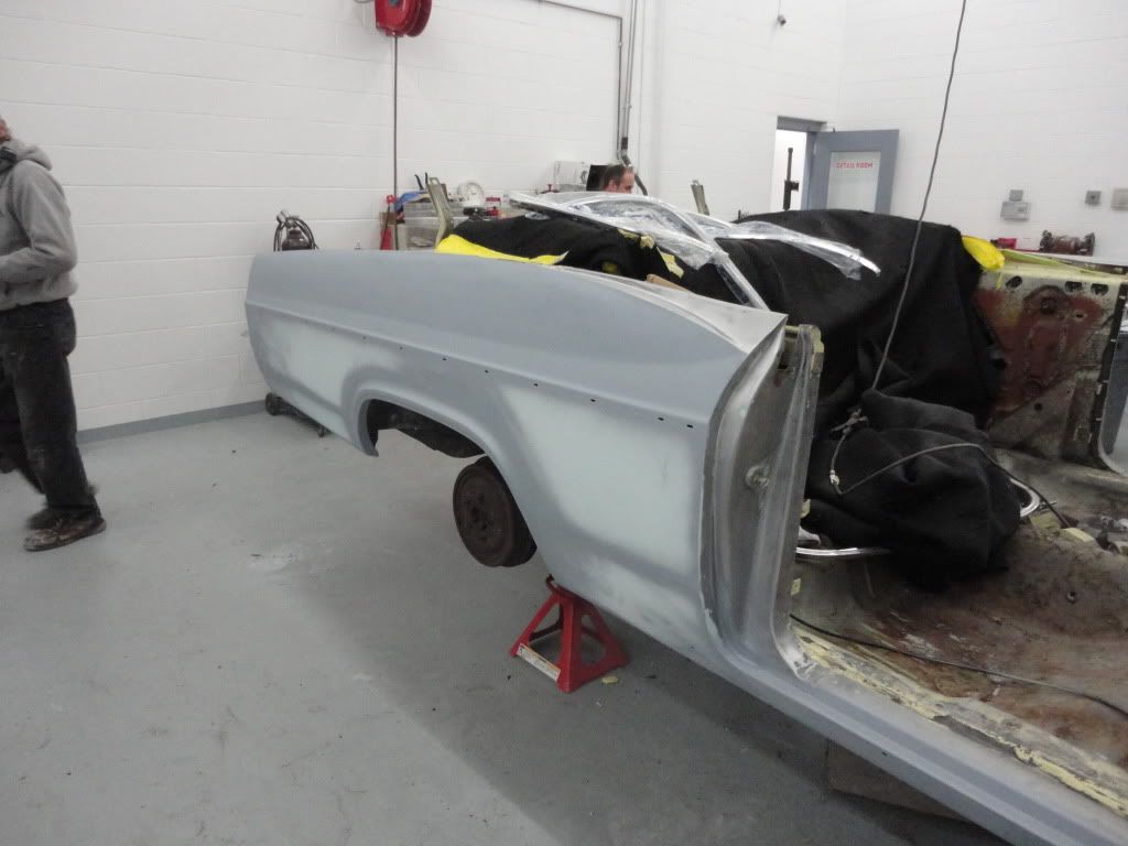

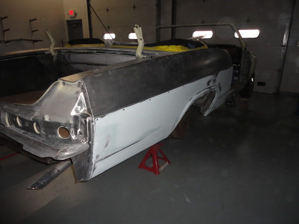

George was a busy boy today.....He got the passenger quarter pretty much finished and was doing some minor sheetmetal repair to the driver side wheelhouse today.......

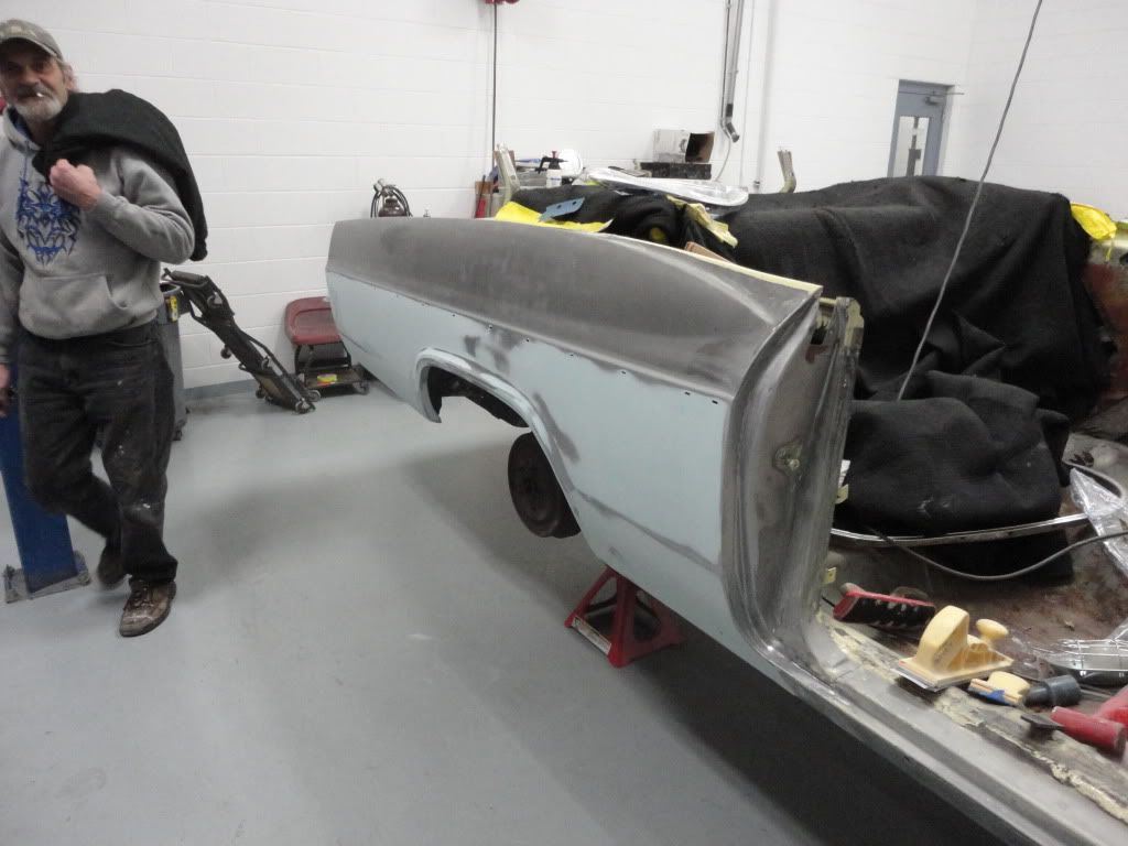

George was working on the drivers side today.......He is probably gonna be working on the &quot;Crashed&quot; cars again next week....we had some bad weather and Puleras got slammed with the wrecks........Darn!!.......Going to pick up the 12 bolt tomorrow...
