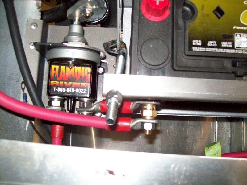

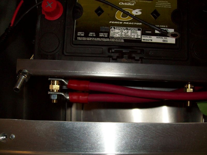

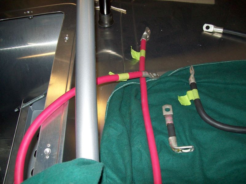

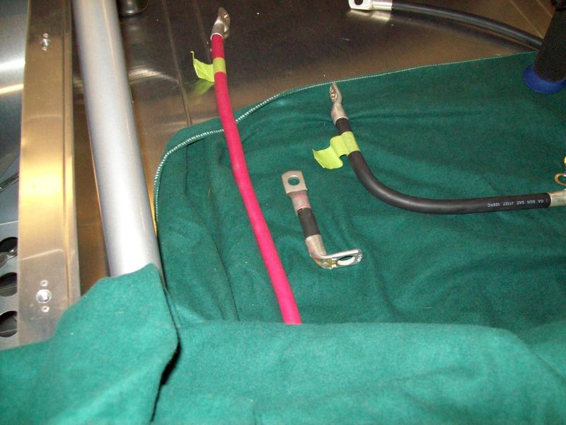

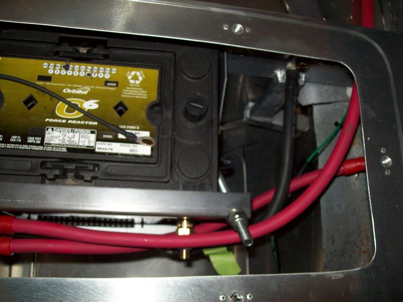

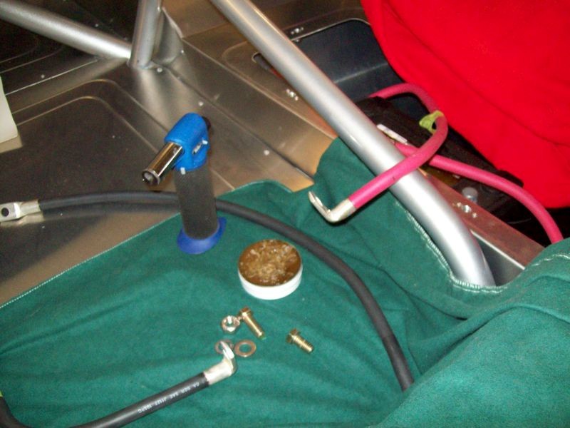

<span style="font-size: 14pt"><span style="font-weight: bold">Batts &amp; Main Disconnect-I made up all the cables w/00 AWG &amp; soldered &amp; crimped all.</span></span>
Dicky

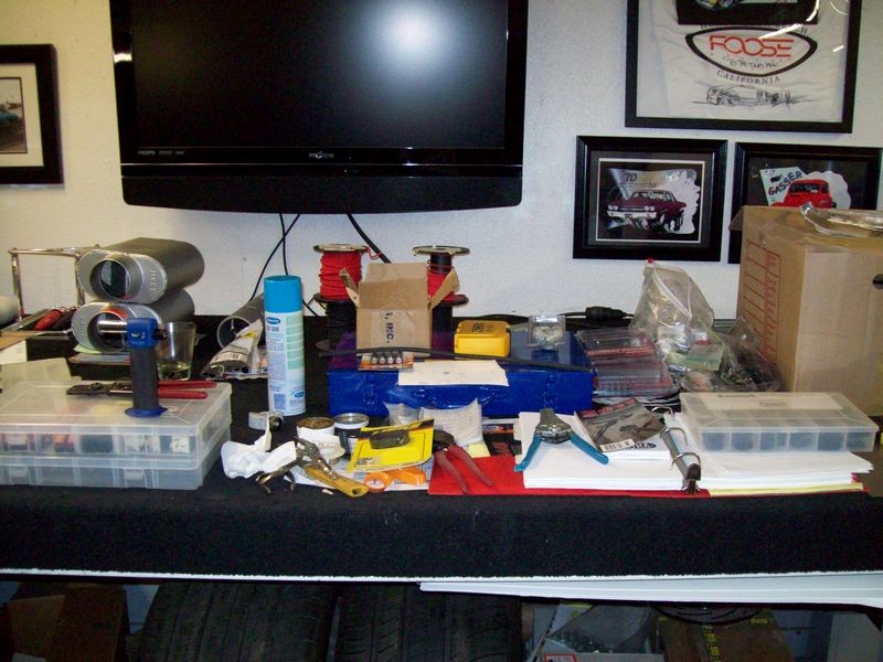

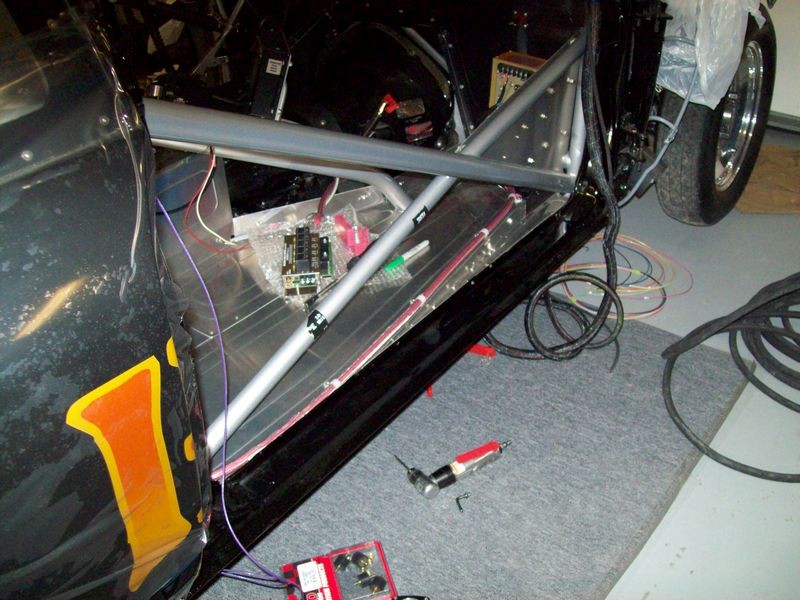

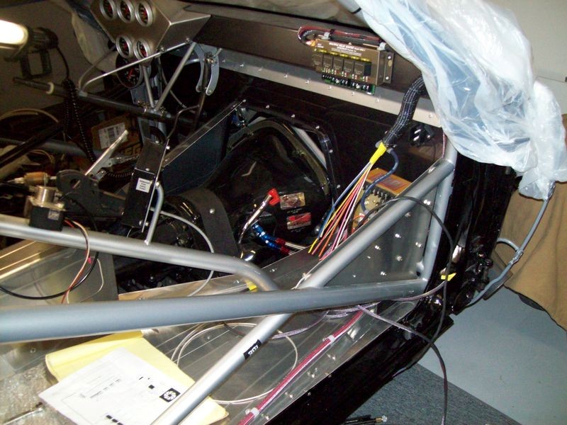

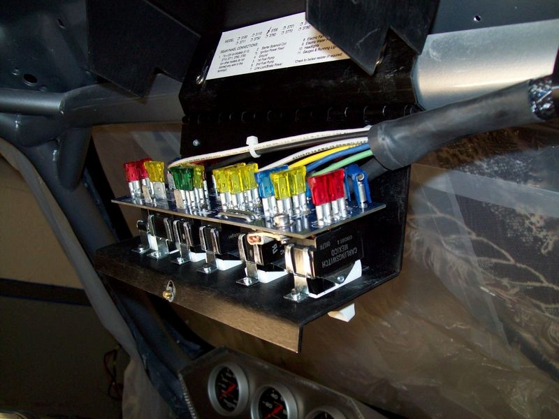

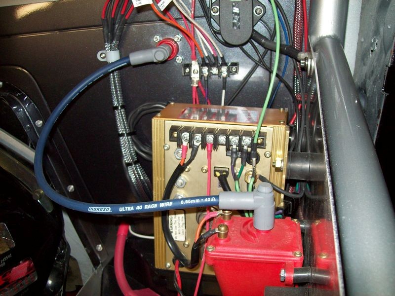

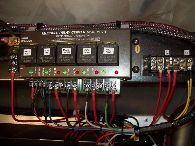

<span style="font-size: 14pt"><span style="font-weight: bold">NOW FOR SOME SMALL WIRE....</span></span>
All terminals were crimped then heat shrink applied after removing all the cheezy plastic insulators on them. Then all the components were connected to the wiring with weather-tite connectors. And of course all the wire bundles were run in flexible conduit.
DH [img]<<GRAEMLIN_URL>>/flag.gif[/img]
Dicky

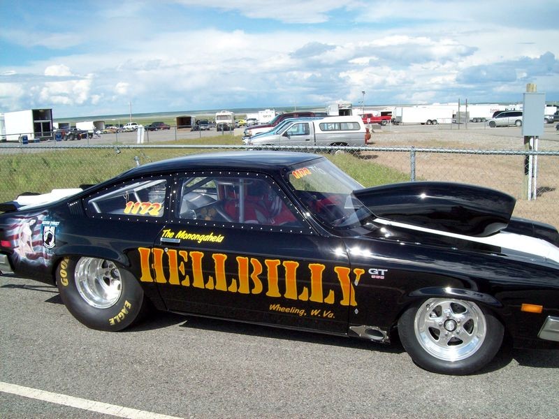

<span style="font-size: 14pt">WE'RE GETTING CLOSE....
</span>

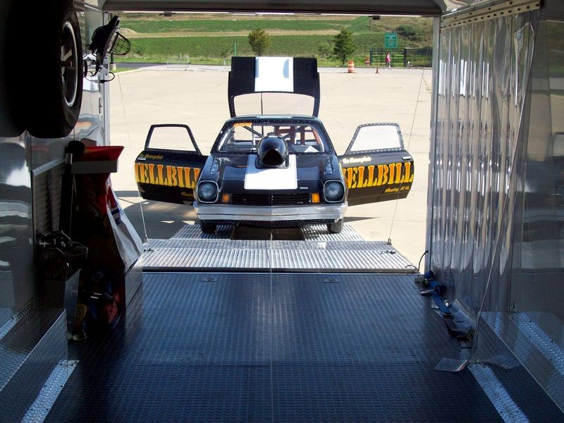

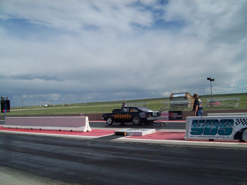

Andre' built the new wheelie bars and dropped them at the powdercoater's in the afternoon; And I went back and picked them up at 12:30 AM so we could go to the track for some shakedown runs the next morning. We ran taps thru the threads while they were still almost to hot to hold onto...
<span style="font-size: 11pt">And a couple pics at the track...</span>
Dicky
