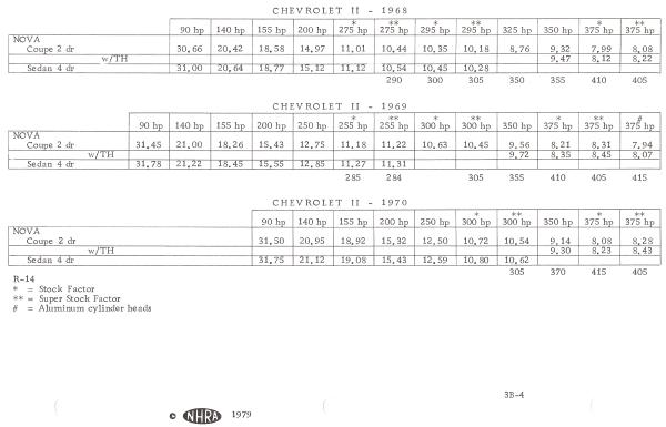

Here's the corresponding page from my original Class Guide...(I'll try and get a scan of the class breaks from the '68-'72 seasons this afternoon):

1968 S/S
1969 S/S
1970 S/S
1971 S/S
1972 S/S

Great info Rob....thanks for sharing this.
