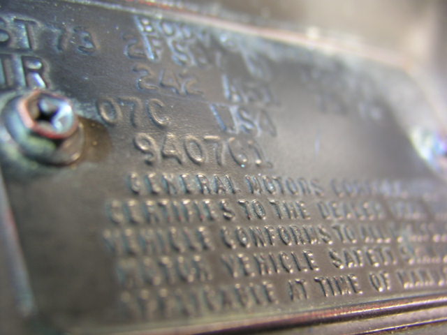

Rick..It is red oxide primer under the clip.
those screws are everywhere

73 was the first year they started using those crazy hex head screws to retain the cowl tag. Same screws should be holding the rear window/trunk filler panel, too.
