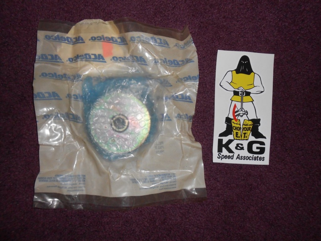

Thanked 5 Times in 5 Posts
Default Re: '70 LT1 Alternator Pulley & Fan Finish
This is how GM was finishing them several years ago.
