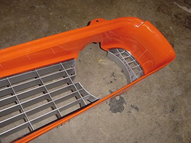

I'm asking for a buddy of mine. What color should the grille be on a 1969 Camaro Z28? Silver, Black, or Body Color Painted?

Non-Rallysport grilles were Argent Silver while the RS grilles were black. Black RS Z's (Code 10) got the silver grilles.

The perimeter of the grill is body color & the crate area is as sc69sam has indicated....Joe

Like this.

And dont forget the upper grill stiffener, its painted as well.
