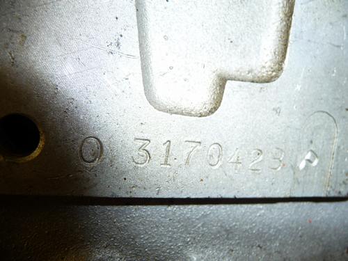

I have a set of aluminum ones going on my 67 Z and a set of iron ones somewhere. The alum ones have have 0 part # stamped in them though making them experimental.

the 292 "turbos" were angle plug.....they also made a 492 which was angle plug also I believe...both these were steel....I also have a set of angle plug o-dash part number alum chev. heads, but they are from 1963 I believe..then there is the "hemi" angle plugs from 69 which were aluminum. What heads do you have Charley? What year are they?

Mine have bolt holes on the end of the heads but I don't remember if they have dates. They aren't here to check. Part # is stamped on the end of each head.
