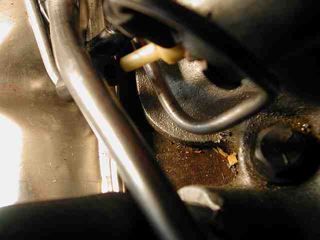

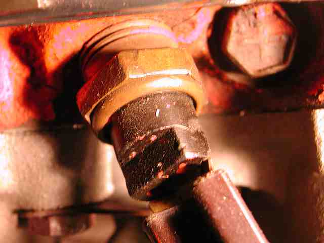

I'm getting ready to assemble and paint the engine for my 69 ElCamino. The machine work will be finished tomorrow.
What did the original paint look like around the aluminum intake and intake gaskets? If the intake and intake gaskets should be oversprayed orange, I don't think I can bring myself to do it that way, so I'm looking for advise on how you guys paint around the aluminum intakes and which (brand) gaskets you use. . I will mask off the intake area, then I'll paint the block and heads orange. When that's all dry, I'll install the intake.

Here are two the SCW guys did and two from an LS-6 I did many years ago. Truth be told, you either love it or you hate it. As far as we are concerned, it is what our customers wanted.

You guys are killin me!! Now that I see the pictures of the Nova, (thanks Rick) I really like that original over sprayed look. Then again, I like the clean look too. This may come down to a coin toss. Thanks guys, for the opinions and feedback, but all this did was make the decision harder. :
