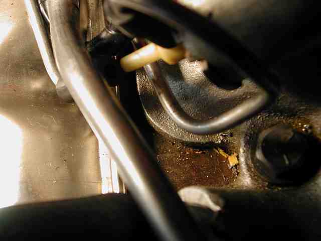

Here are two the SCW guys did and two from an LS-6 I did many years ago. Truth be told, you either love it or you hate it. As far as we are concerned, it is what our customers wanted.
