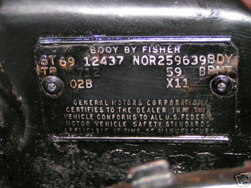

If the trim tag was re-rivited,then that would be interesting,the only way to tell then is by the vin?Here is the trim tag

Those rivets don't look original!

Real tag, bad rivets. But the tag date lines out with the VIN.
dave
Dave,
How closely does the cowl date & Vin "line out" as you
mentioned? Do the non-original rivets indicate that this
cowl tag was affixed to this car sometime after original
manufacture?
dave
Dave,
manufacture?
First car in Feb was 589721 and the last one of the month was 607164. Tag may be original to the car, but has definitely been off and then put back on with non-original rivets. Unfortunate, because now the car will forever be questioned, even if it is the original tag.
