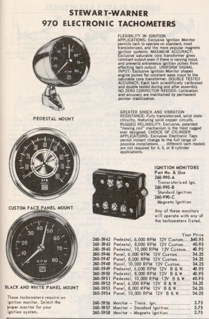

You could get a SW 970 in 6-8 or 10 grand face.They made a custom greenline face as well as a std black face tach.They were all made during this time period and were "just" another aftermarket tach........

Default Re: Yenko Chevelle Tach
1969 ad.......
