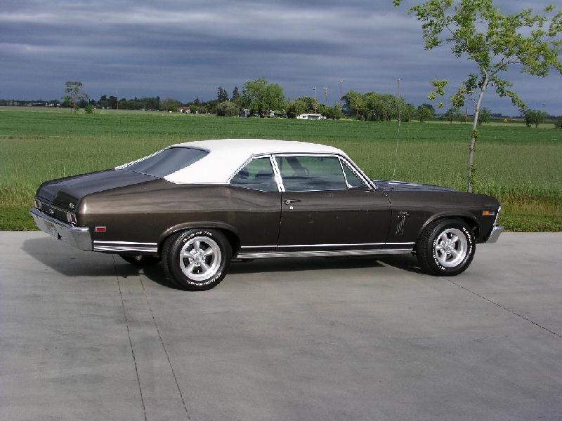

Went to look at a car advertised in the paper today as a 69 Nova SS 396 car.Original light green car black int out of Calif this summer.Trim tag = ST69 11427 WRN364563
TR 744 59 59PNT
03E O M 2
VIN 114279W461428
Has a fresh 396 in it block pad 5012362 0T0302 LB
My book says LB is 65 325/396 or 69 335/427.Cant see the back of the block.Is it even a "real" SS car let alone a big block car? I did notice a 10 bolt rear.How can I tell? Price $11,500 [img]/ubbthreads/images/graemlins/dunno.gif[/img]

Here's a few things for starters..
SS should have Power disc brakes. SS cars could have a 10 bolt rear, but If original BB, should have 12 bolt posi rear. Also, BB heater core, BB rad. support has larger opening, and the radiator Bolts to the support rather than the top plate method. BB frame mounts lift the engine up, and to the right. When looking at the nut on the air cleaner, it should be about an inch towards the pass. side of the car. Something else to look for, are the brackets on the rear studs of the hood grilles. [img]/ubbthreads/images/graemlins/scholar.gif[/img]

To build on Dennis's list, even though it has a green interior, the steering wheel and column should be black and there will be an SS emblem on the horn pad.
There should also be a BB style heater box cover (like the Camaro) that has the heater core outlets closer to the fender, rather than right behind the motor.
Along with the 12-bolt rear end with the BB, there should also be a larger diameter fuel line (3/8"), and maybe two lines (a return line) if it was a '69 with the L34 396/350.
Finally, that setup would have came with factory dual exhaust, and there should be the hangers/mounts on both sides in the back.
Some of the items listed are SS equipment, and some are specific to a big block (heater box, radiator core support, engine mounts, etc).
The bottom line is: without any paperwork, documentation, verified past owner histories, or the original engine, there isn't an easy way to determine it. Mainly, you have to put together the clues.

Real 396 Nova's here in the West are selling in the low $20000 range. If the car is $11500, there is something wrong......too much rust, never a SS.....never a 396. I sold a real SS 4 speed with its original 350/300 that was a very solid California car but needed complete restoration. It ran and drove OK. Got $6250 for it. Hope that helps.

Thanks guys for the info.The car is 3 hours from where I live so im not sure what to do.I do remember the hoses out of the heater box were all the to the right/away from the engine.I am a little confused as it was modified so to look like they made room for the valve cover but why would that have been if the hoses were on the other side anyway. Like I said before im trying to figure out if it originally had a big block in it .I dont think this is the original motor according to the front pad that even makes the car more in question.I do think it is a real SS.The car is not rusty at all.I need to do more looking at the car although I am thinking it is a waste of time.

This car was on ebay. I am fairly certian this is not a Big Block car becuase it originally had Air Conditioning. My notes mention "Interesting AC heater conversion in engine compartment". I will look to see if I kept the pictures.
Greg
Here is the link to the auction. I have an email from the seller with this auction number and the above VIN. Seller is in Oxnard, CA. It now has a black interior and AC vent still in the dash and AC vent kick panels. G. Ebay Link
