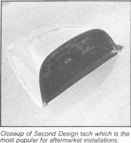

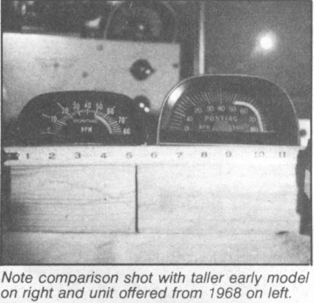

Other info i have on Pontiac Tach
First design 1967.
Old 01-09-2003, 06:09 PM
copo9566aa copo9566aa is offline
Location: Montréal, Québec ,Canada Je me souviens
Posts: 1,112
Thanked 3 Times in 3 Posts
Default Re: HoodTachTech
Second design 1968...

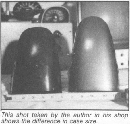

1967 and 1968... top size.
1967 and 1968... front.
