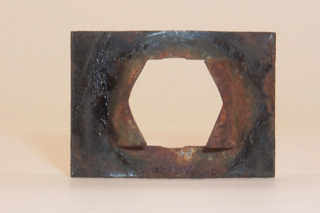

Jim
Also remember to save the clip that holds everything together on the radiator support. That clip also is not in any kit. If you have back issues of NNN, go to November 1998 page 13. It has a nice picture of that clip. I have no way of posting that picture. Greg?
Ron

Ron,
You mean this one? It is available. I have seen it in at least one Camaro catalog.
