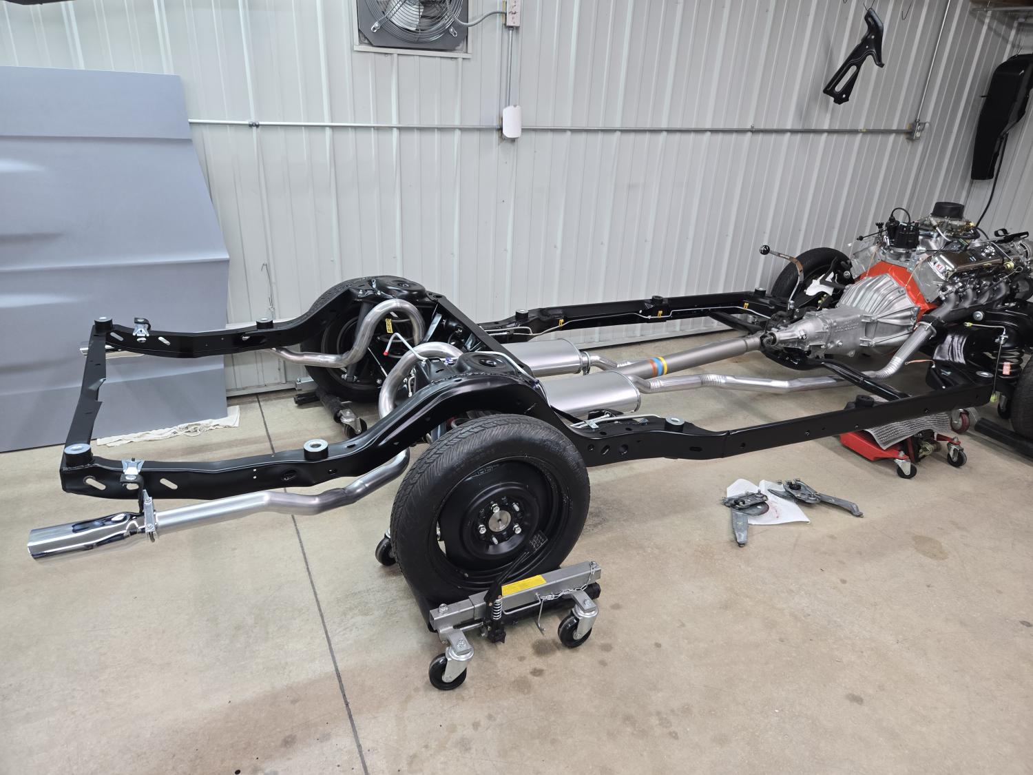

Default Exhaust
It wasnt tough, and everything fit nicely. Alway hard to judge the tail pipes till the body is on, but piple snake through all the clearance areas nicely, and tips are at the same height off the floor. Should be able to drop the body on soon.
It is a Gardner with turbo mufflers. Im fortunate to have a good paying job as I dont how some afford restorations anymore.
