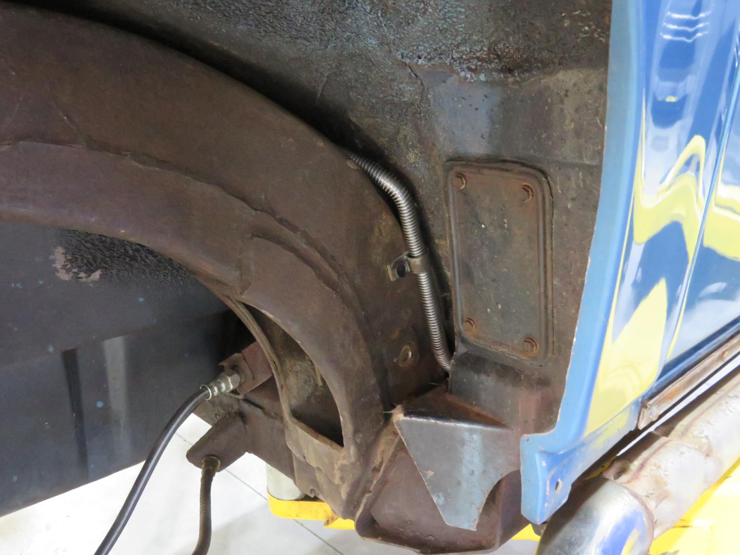

I've been working on a few of the not so glorious items. The fuel line had been replaced in the car with rubber hose. No bueno. The problem with these cars? The body has to be lifted off of the frame to install the line as a one piece unit. With assistance from Tim G, I was able to solicit some advice how to get it done. I have one visible clue that the line was cut. The other 2 cuts are really well hidden.
