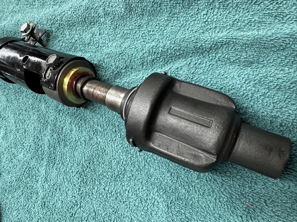

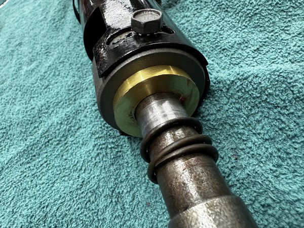

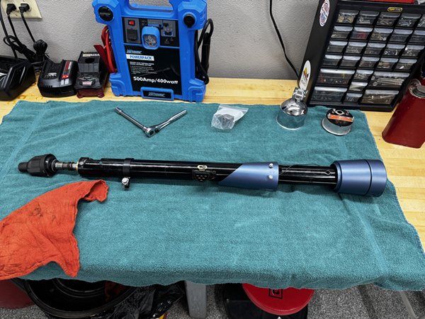

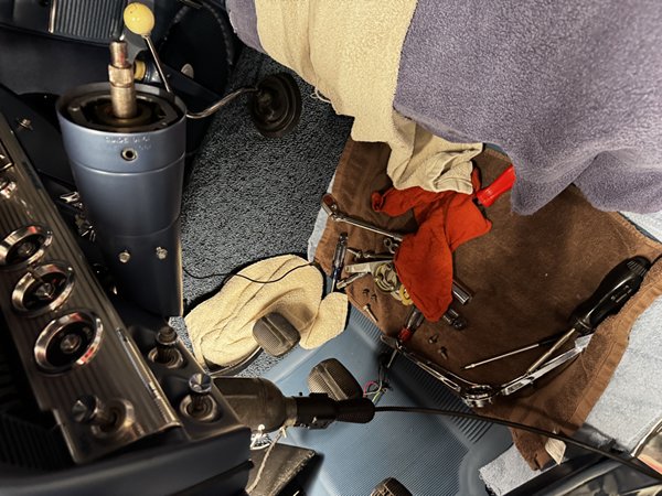

I found a solution for the lower steering column bearing. When I tore the column apart a few months back I could not find a replacement for the lower bearing so in an effort to get the car back together and driveable I put the old bearing back in. There was some "slop" in the column to the point where you could move the column shaft up and down a bit from the engine side, but nothing unsafe. Fast forward to last week and I found a replacement option from Southeast Chevy Parts. They offer a brass bushing in a factory bracket that fits in the orignal location rather than a stock ball bearing replacement (which I still can't find anyways). I had some time last night so I removed the column (again) and installed the new setup. While everything was out I re-did the coupling piece that I previously incorrectly painted black. Subsequent research suggests that this was grey phosphate - so that's what it is now. Got the column re-installed last night but called it quits prior to hooking evertyhing up and re-installing the steering wheel, hope to finish that up tonight.......which leads to my other little project.
