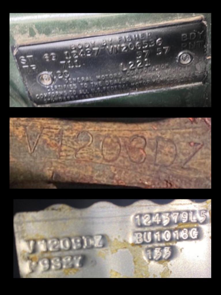

Default 1969 z28 jl8 zl2
California Black Plate car
https://sfbay.craigslist.org/sfc/cto...519891415.html

Looks great but more solid proof of JL8 originality than a POP necessary.
VN206536 12C L221

124379L512994?

Car is on Facebook. Not a factory JL8 car and he knows it

Also that is not an untouched original judging by the firewall and the baggy looking reupholstered headrest.
ZL2 was also added.
Said it was repainted back to original color in 1997.
Drive train stampings will tell all here.

BU on PoP so it's a normal factory 3.73 12-bolt. Way over priced at $90K given condition.
