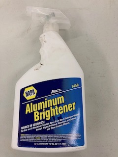

X2 on the EASY OFF HD!
Something with even more toxic fumes that has saved me countless hours on a current cleaning and preservation project, Aluminum Brightener from NAPA. Removes grime like nothing else I've found but doesn't harm factory paint or EDP on underhood metal and firewall blackout. Spray, wipe it off, neutralize with water, and follow with wax.
Also spectacular results on phosphate and zinc stuff (horn relay cover, ash tray) and of course aluminum (alternator, a/c lines).

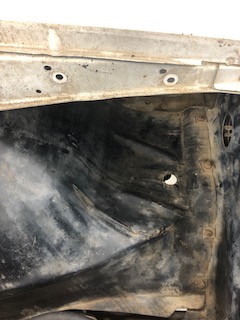

Here is before and after. Before had been scrubbed with full strength Simple green and Purple Power.

Bill, is that the wagon? Looks great! When can we see more pics of the progress?

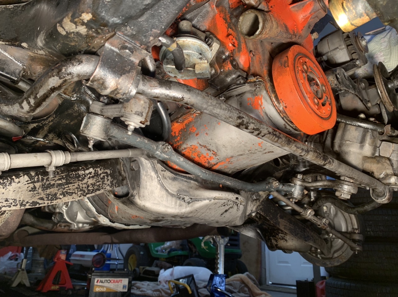

Granted not firewall but I’d use the same steps on it as well.
Zep citrus degreaser, blue scotchbrite pad, micro fiber towels, #7, & Mirror Bright Rubber & Vinyl. Oh and insert evaporust before #7 & Mirror.
