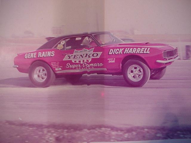

I know the supercars were kings on the streets. I'm trying to get a handle, though, on where they stood back in the day, when taken to the NHRA or AHRA drag strips. How would they have been classified? I've searched online but haven't been able to dind much.
For example, in '67 or '68, l think most big block Camaros (like Jenkins' Toys) would run in SS/C or A/MP in full race trim. What would a '68 or '69 race prepped 427 Yenko/Nickey/Motion, etc. be run in? Also, how would a streetable supercar be classified if all tou did was throw a set of slicks on it?

In 1967, Yenko built a minimum of 50 427 Camaros to make them legal for AHRA Super Stock racing.
Dick Harrell and Don Yenko worked with the AHRA to get the cars approved.
Many of them were built with scatter shields, headers , hood pins, and traction bars and had other options available including fiberglass hoods and decklids, 2x4BB intakes, L88s, and rear gear options.
There were two red 427 Camaros sponsored by Dick Harrell and the Yenko Super Camaro Dealers. One was red , the other red with black top.
