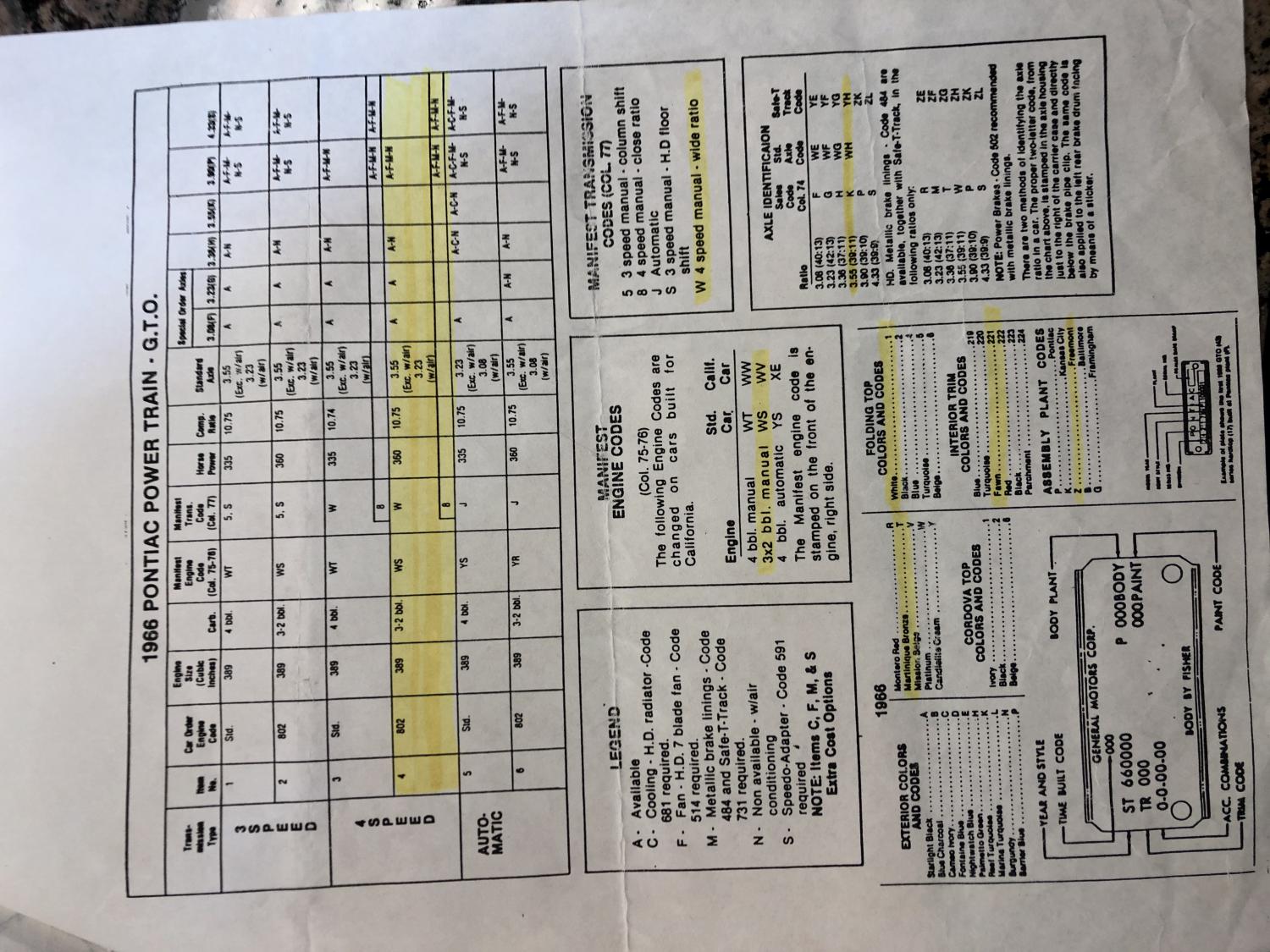

It looks like there are now more pictures and information on the cars on Mecum's website. Some of the cars even have documentation posted.
Here is a picture of the 66 GTO convertible and it's PHS documentation. It looks like this one wasn't originally black.
